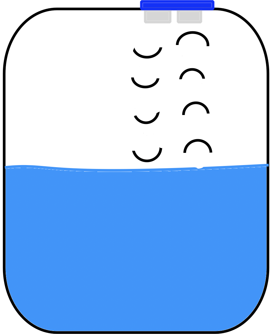

Step 1: Why an Ultrasonic Sensor ?
An ultrasonic sensor will sense the distance by using sound. So, I have used an ultrasonic sensor in order to measure the distance that varies based on the level of water in the tank. The main reason why I used an ultrasonic sensor is that its simple to install and most importantly, we don't have any problem with corrosion that we face in a sensor that senses the water level underwater.
