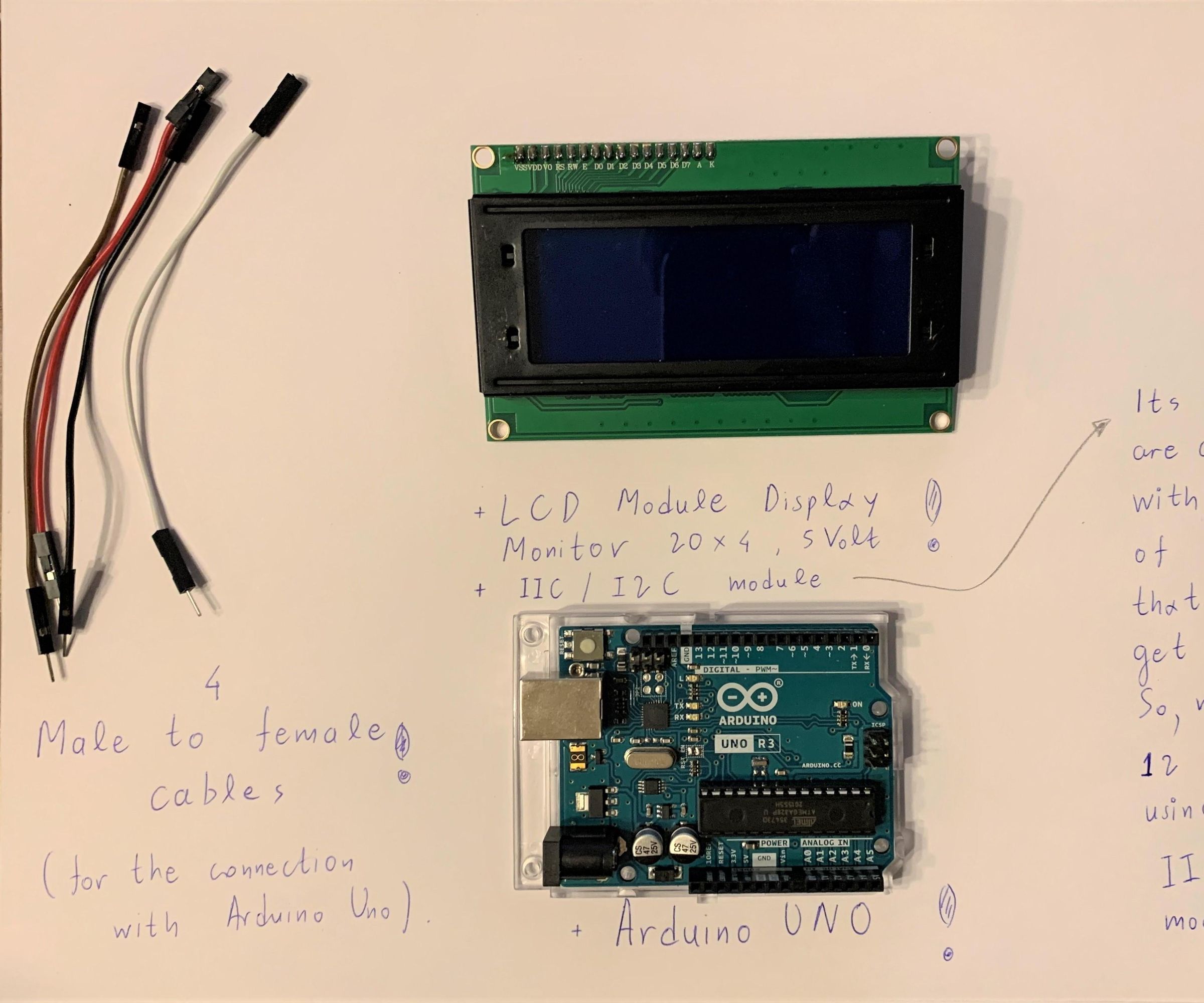

Step 1: Components
So, in order to get started, we will need some components :
- An Arduino UNO and a USB type: A male to B male.
- A LCD 19x4, 5V (16 pins).
- A IIC/I2C module (16 pins / 4 pins ) in order to minimise the wiring between LCD and Arduino UNO.
- An ultrasonic sensor, and in my case, I have the HY-SRF05 ( 5 pins, we only use four).
- 4 x Male-to-female cables that will be hooked up to the I2C module.
- 4 x Male-to-male cables that are essential for the HY-SRF05. - About 6 to 7 helping Male-to-male cables.
That it depends on you :
- 2 x 170 points Breadboard ( or use a breadboard with 830 points e.g. )
Optional :
- A 9V battery and the corresponding connector with a DC plug in the end, which has to be compatible with the DC power port of Arduino UNO.
