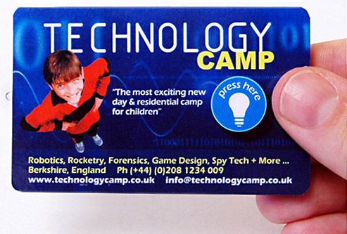

Step 2: The Foam Insert
Cut out a foam rectangle a few mm shorter on each side than the credit card, and cut a 20mm diameter hole into the middle of one end as shown - exactly where isn't crucial, but it should be close to one end. A scalpel will help with this, although with younger kids scissors are best. I cheated and did my prototypes like this, but ran off the rest on my laser cutter. You can also cut out a notch as shown about the same width as the LED, but this isn't crucial. To make it easier if cutting out by hand, it actually works just as well if you make the 20mm cutout a square (with sides 20mm) rather than a circle. Have also attached a PDF of the pattern I used if that helps anyone.
Now you'll need to stick the foam onto the card - I used two strips of special high-strength double-sided tape, but for most people a glue gun will be a better choice. It works best just putting adhesive along the two long edges I've found.

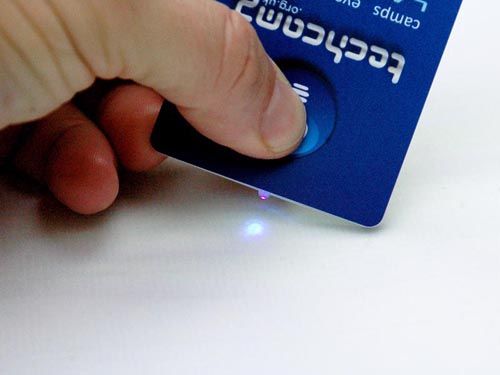

Step 3: Put in the Battery
Now put in the coin cell into the cutout in the foam. Don't worry about which way up you put it at the moment.
Step 4: Attach the LED
You will need to pull apart the legs of the LED a little, but trying to keep them roughly parallel. They need to be about 5mm (1/4") apart, but this is not super critical.
Now push one leg underneath the cell (will go between the card and foam), and the other leg should go above the cell.
If you have done it correct, when you press down on the leg which is on top of the cell, the LED should glow purple.
If it doesn't glow at all, pull it out, rotate it 180 degrees (so the opposite leg is on the bottom), and put it back in.
If it glows all the time (without pushing), you will need to pull it out, spread the legs further apart, and put it back in again.

Step 5: Complete the Other Side
Now stick the other card down in a similar way to the first one.
Step 6: Investigating Fluorescence
Now its time to use the cards - if they have been constructed properly, when they are squeezed at the end of the card near the LED they will turn on.
