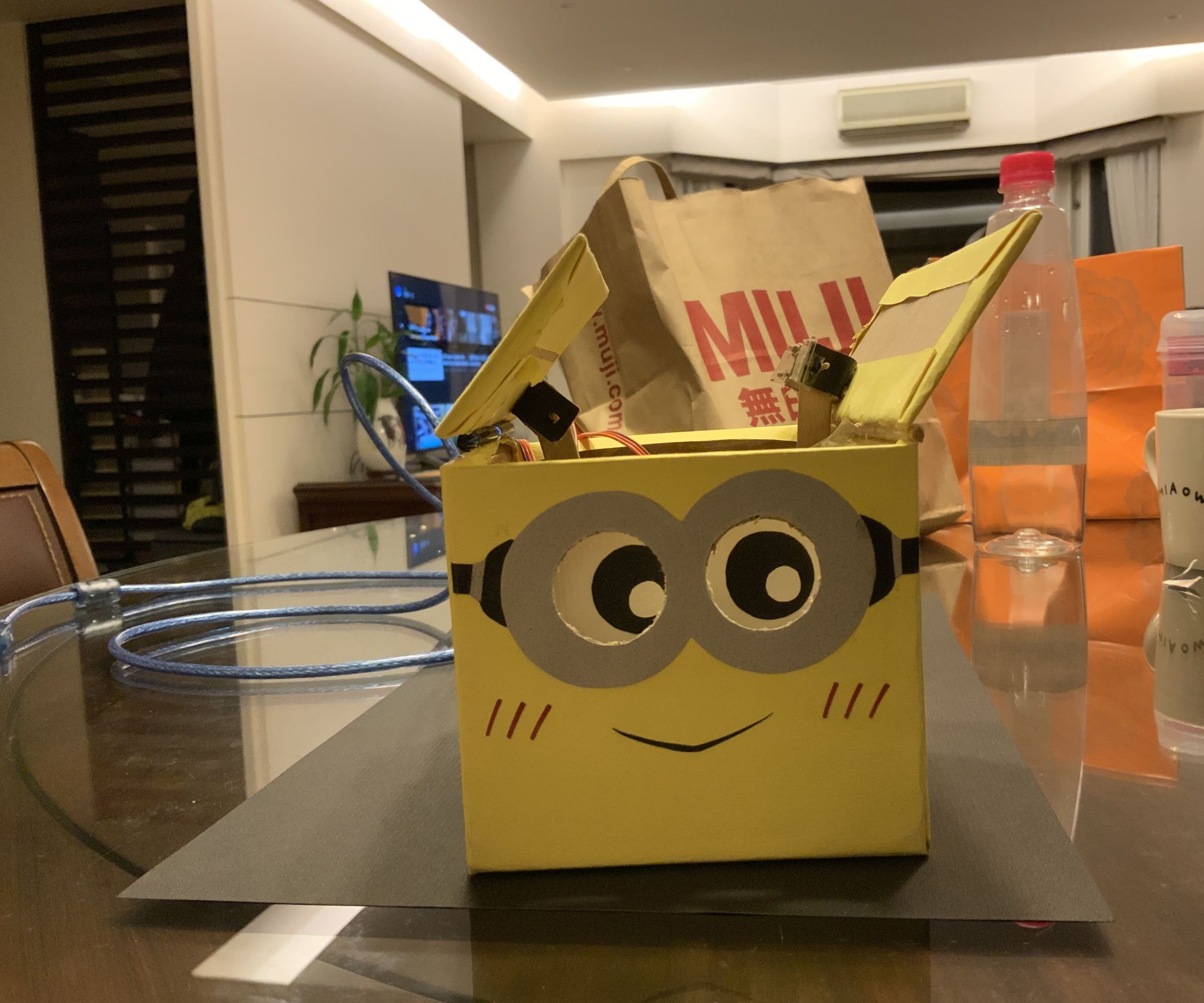

Step 10: Build Up
Make a base to fix palate's Servo Motor and fix the jaw, so it looks like a wide-opened mouth.
Then stick the Ultrasonic Sensor Library on the central closing, so whenever people approaches the mouth, the Ultrasonic Sensor Library near by will send message to the Servo Motor, and it will help move the palate.
DONE~
