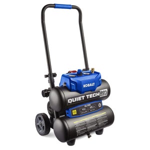

Step 8: Compressed Air
Many nailers run on compressed air from an external air compressor.
Air compressors can be powered by electricity, or gas engines.
