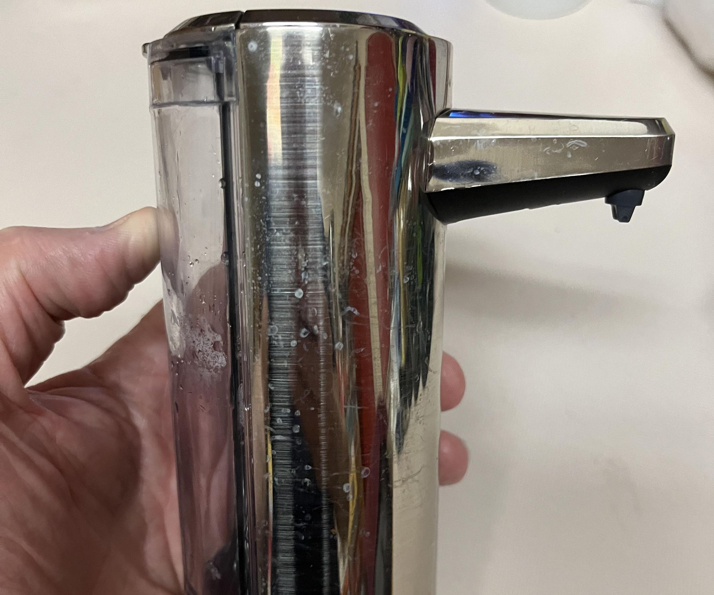

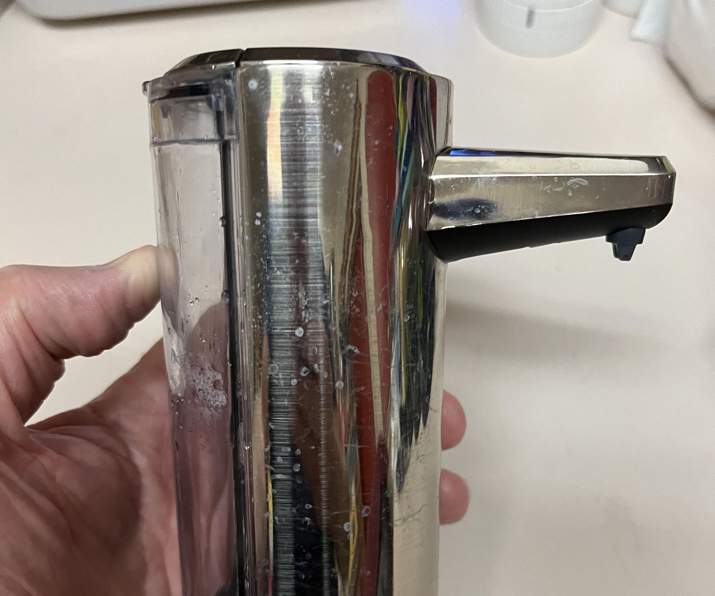

Introduction: Unclogging a SimpleHuman Soap Dispenser
The SimpleHuman automatic soap dispenser is a touch-free pump that puts soap or sanitizer in your hand when you place it under the sensor. These are great in dispensing soap without having to touch anything but over time the soap can dry out (or if you use too thick a soap) and form a blockage in the tube leading from the pump to the dispenser port.
If this happens, the pump will whine but not dispense any soap. Sometimes you can flush it with water or thinner soap but if the blockage is too thick the only way to fix the problem is to disassemble the pump and remove the blockage.
Step 1: Backflush the Soap Feed
I learned a new way of clearing soap blockages if they aren't too big. That means you don't have to completely disassemble the pump. It only takes a minute so it's an easy step to try.
Fill a SmartWater Sports bottle with hot water and place the blue nozzle to cover the output of the pump. Press the bottle to force the water down the tube and force any clog back into the reservoir.
- There is a lot of pressure when you squeeze the bottle so if you loose the connection with the soap dispenser you will squirt hot water all over the place. Don't ask me how I know this.
- The SmartWater Sports bottle has a nozzle you drink from that's the perfect size for covering the soap output feeder. It's also perfect for backflushing a Sawyer Mini Filter.
- You can use any other mechanism that allows you to force water back through the feed tube with sufficient pressure to dislodge a clog.
