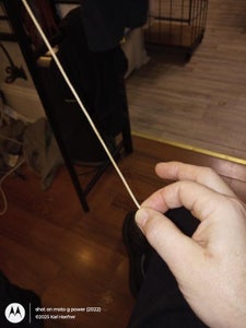

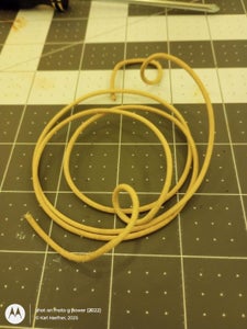

I have a project that is going to use leather cord. However, it keeps curling up even though it is off the spool. I need a way to straighten the cord. The first idea I had was to use a wire straightener (that Instructables is here), which worked fine. However, I came across a video of someone using a steamer to straighten bolo cording, so I thought I would give that a shot. Here are the results.

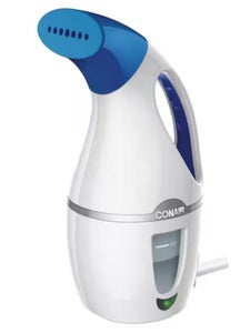

  1. A garment steamer.
  2. I bought the cheapest one I could find. This was at Home Depot.
  3. I actually got it free because I had built up credit by using the Capitol One Shopping extension for Firefox.

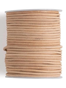

  2. A length of leather cord that keeps trying to curl even though it is off the spool
  3. Mine is 2mm natural leather cord from Tandy Leather.
Step 1: Cut the Cord!
Cut the cord to the desired length, BUT add a few inches for the part that is going to be secured in the next step. This part will NOT be straightened by the steam. For the purpose of this demonstration, I cut a 3-foot length.

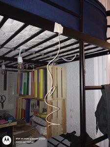

Step 2: Hang the Cord
Hang the cord somewhere. I am using some masking tape and my loft bed. You could tape it to a door frame or tie it to a light fixture. The choice is yours, as are the consequences.

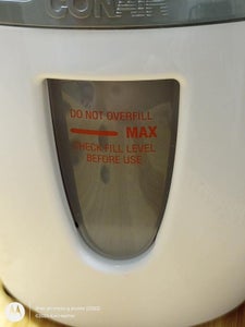

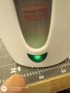

Step 3: Fill the Steamer
Pour the distilled water into the steamer per the steamer's instructions. My steamer has a "maximum level" line, so I keep an eye on that while filling.

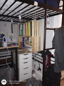

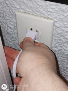

Step 4: Turn on the Power
Plug in the steamer. If your steamer has a switch, turn the steamer on. Mine has a light indicating it is getting power.

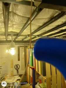

Step 5: Watch for Steam
Watch for the steamer to start producing steam. I'm not sure the picture does this step justice, but it is steaming. It took what felt like a minute; it wasn't a long wait.

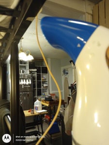

Step 6: Steam the Cord
While holding the cord at the bottom and pulling it taught, run the steamer up and down the cord. I make sure to get multiple sides of the cord.
Step 7: Voilà!
You now have a straightened, although not perfectly straight, piece of leather cording to do with as you please. I know it is hard to see in the picture, but it is there. Now I can move on to what I want to make with the cord.
