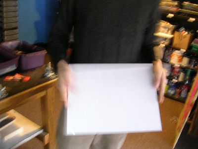

Step 2: Aquiring Plastic
I decided that I didn't want to be tracing on glass because I tend to break all things glass so I made the tracing area out of plastic.
I found this nifty 11x14 sheet of .25 inch clear plastic at Home Depot for $3, it seemed a good size for the drawings that i'll be doing.

Step 7: Plastic Fixins
So now that the table itself was done, It was time to work on the plastic. I didn't like the idea of my light table blinding me so I decided to frost the glass. I took the clear plastic, sprayed it with adhesive, laid down some paper on it and cut off the excess.
Step 8: Finishing the Table
Then I set the newly frosted glass into the table again and glued it down with gorilla glue. If you want you can cut a 0.25 inch off the paper on each side so that you're gluing the plastic to the table not gluing the paper to the table. It's probably more sturdy but I haven't had any troubles with this method (I bet you could even go without gluing if you felt so inclined)
