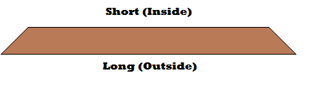

The frame consists of 1 X 2 boards with the ends cut at 45 degree angles so they can be connected with Miter joints.
You can use a table saw or a miter saw to make the cuts. (Exact 45 degree cuts make the cleanest joints, so you may want to test you saw’s settings on some scrap wood first.) I’m not providing the length of the boards since it would only work if your shelf was the same dimensions as mine. To have a clean fit, the “long” sides of the boards need to be the same length as the sides of your shelf.
Next we need to cut a dado along the Short (inside) length of each piece. (A dado is just a fancy word for a groove.)
In each board, cut a ¼” deep dado along the entire length of the inner side. The dado should sit about ¼” from the bottom edge. The width of the dado needs to be slightly larger than the thickness of your diffuser panel. You can use a table saw or a router to do this. If you ae using a table saw, you don't need any special blade to make this since the width is not critical. To make my dado, I just made two passes with a standard table saw blade, moving my rip fence over 1/8 inch between passes. If you use this method, make the first pass on all four boards, then adjust the fence and make the second pass, this will ensure the grooves line up on each piece.

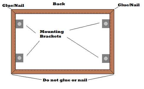

Step 4: Build - Assemble the Frame
Dry fit the four sides together to make sure you have a nice square frame. If everything fits together nicely, decide which side will be the front and which will be the back. (If it doesn't, check the tips section at the end for some advice.) Glue or nail (or both) the back corners, but leave the front corners unattached. Miter joints have a tendency to slip, so it can be helpful to use some clamps to to keep the corners square.
Once the glue has dried, drill a hole into the back on the side closest to where the power adapter plug will be.
If you are planning on painting or staining your frame, now is a good time to do it.

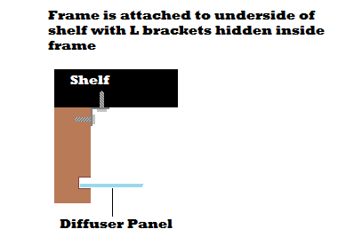

Once your paint/stain is dry, attach the L-brackets to the inside of the frame. Exact positioning doesn’t matter, but try to keep them fairly even on each side. The tops of the brackets should be flush with the top edge of the frame.
Step 5: Hang the Frame and Light Source
You can now attach the (currently 3 sided) frame to the underside of the shelf using the L-brackets.

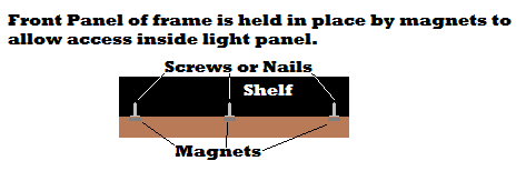

The front if the frame is removable to allow access inside the light fixture. It is held in place by magnets.
Drill the holes for the magnets into the top of the frame piece. (A forstner bit will give you flat bottomed, holes) The holes should be the same diameter as the magnets. The depth should be slightly deeper than the magnets. Put the magnets in the holes to check for fit. The magnets should sit slightly below the wood surface. Remove the magnets, place a small amount of epoxy in each hole, and insert the magnets. They should be nearly flush. Let the epoxy cure.
On the underside of the front edge of the shelf, mark where the magnets will be. Insert a screw or nail in each spot and be sure it sits flush. If everything is lined up right, you can stick the front panel in place and the magnets will hold it secure.
Full disclosure: In the end, I couldn’t use this magnetic mount. I believe the idea is sound, but the design of my existing shelf prevented it. My shelf has sliding doors which ride in recessed grooves. Unfortunately, the place where the screws needed to go were directly under the door grooves. The screws would have poked through the groove and prevented the doors from sliding. Right now I just have the front panel held in place with clear tape. For a more permanent solution I am going to screw the joints together. (So much for my clean look…)
