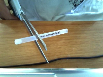

The nylon spacers, screws, and rubber lined clamps are in the screws and parts section. They were in the pull out bins. You can cut a pen to use instead of the nylon spacers if you want to save $1. You will need 2 screws that are about 1/4" longer than your spacer so that it screws into your desk far enough. You certainly won't want it too long, or you'll have screws going all the way through your desk.

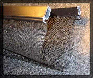

Cut the screen frame to the size you wish to use. I cut mine at 36". I didn't have a saw handy, so I ended up scoring the metal with a leatherman saw blade and bending it until it broke. The metal is very pliable, so be careful of deforming it.

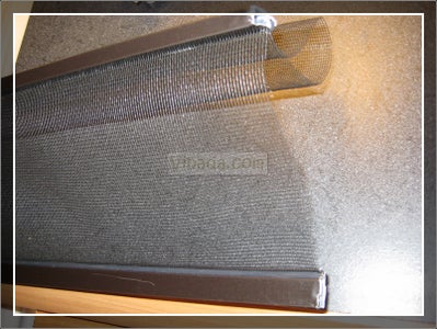

Measure the amount of screen you wish to use. I measured mine at 24" so my screen dimensions are 24"x36". I should have used 10"-12", but I worked around it (by creating a closed loop in case I want to "permanently" route cables). Always give yourself some extra slack. You can use less than needed and cut off the excess.

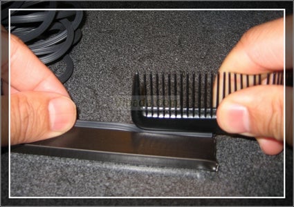

Install the spline into the screen frame. The proper method is to use a spline roller, but I couldn't find mine, so I used my curved leatherman file to press it in. You can use a comb, or headphone jack, or chopstick, or any thin, solid material with a blunt end.

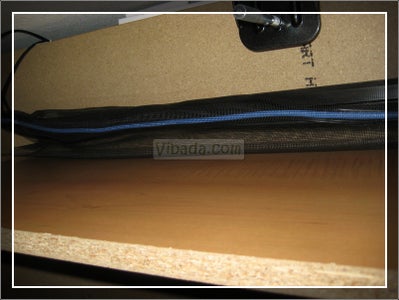

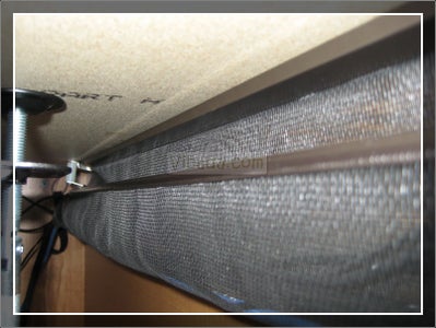

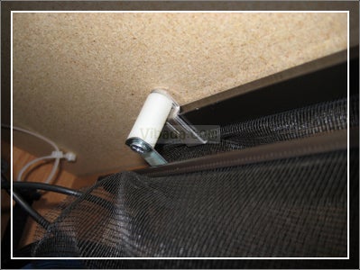

Setup the screen mount bracket. The screen clip will hold the screen frame to the desk. The spacer will create a gap between the two screen frames so that cables can easily run in and out of the organizer. The rubber lined clamps will hold the second rail. It will allow for easy access to route the cables. Hold the bracket against the frame and screw it into place at both ends.

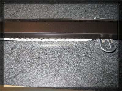

If you're using this setup on glass, you can flip the screen clip, use a nut and bolt to hold the bracket assembly together, and use some adhesive strips to hold the bracket to the glass.

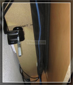

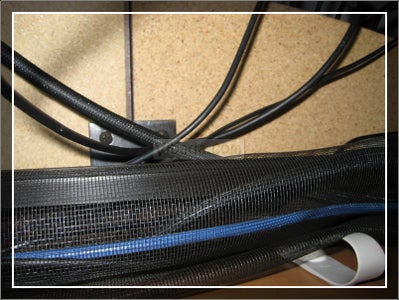

Finished!
I'm happy with the result. It's super easy to pull out a cable. If the management was in view, I would spray paint the parts black.

If you have a glass desk, you can use some double sided tape pads or the velcro strips to secure the frame to the desk. I don't have a full example available yet.
