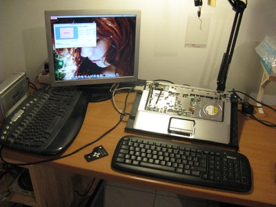

Step 5: Configuring Your Laptop
Good news ! As far as the laptop is concerned, we can move on to taking care of the software part.
Most laptops in the last few year come with a way for you to plug in an extra monitor for dual display or simply better visibility when you're giving classes or want to project video on a wall. In this case, we're going to hook up an external monitor and set it up to be the main display on your system : the actual method will depend a lot on what hardware ,graphic chipset and operating system you're using. However, you can find general pointers for Windows 7 here, and for Ubuntu there.
In my case, the laptop I use came with an nVidia chipset and after installing the proprietary drivers straight from Ubuntu (in System > Administration > Additional drivers), then started the proprietary display management software (in System > Administration > NVIDIA X Server Settings) that took care of everything after just a few clicks. Just make you start it as a root user !
Once this is taken care of (or while your OS is installing), you can take out the aluminium brackets and get on with the prep - coincidentally that's just what's happening in step 6 ! See you there !

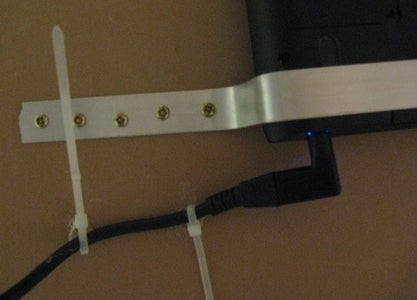

Step 7: Preparing the Brackets 2 - Piercing the Brackets
In order to make sure everything'll hold under the desk, set up screws about every 2 centimeters in the non-cradling part of the brackets. Something I figured out as I went along that made things a whole lot easier : using a metal bit on your drill, give a few rounds at low power pressing into the metal to prime a hole - then accelerate and drill through the bracket.
Of course, do make sure the aluminium brackets are blocked held in place as you drill so they don't start spinning around ! Once you've drilled all the holes you need for your screws, move on to the next step !

Step 9: Adding an USB Hub
Now that the laptop is all snug under the desk, we need a way to restore some conenctivity to it - the front part being still accessible for microphone and headset, we're going to focus on USB connectivity !
I'm sure you've already used a USB hub. Plug in an available port, and...Voilà, you're pretty much done. Depending on your needs, you might want to invest in a powered USB hub instead of your average hub, should you need to use very greedy peripherals.
Another amazing thing to do while you're prettifying your desk is actually embedding the USB hub flush with your desk surface - there's a lot of tutorials (from Lifehacker and from MAKE for example) to do just that floating around here and there are even products designed specifically for that purpose.
All hooked up ? Then let's move on to the next step - managing the mess of cords under the desk !

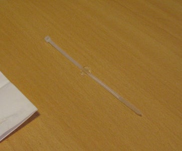

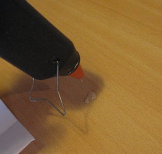

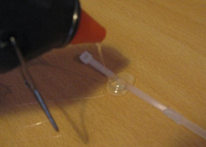

Step 10: Optional - Sorting Your Cables
Now that we have a bunch of wires tagging along with the laptop under the desk, we can take some time to clear up the space some ! First, trace roughly where your cables will pass and mark the points where you want zip ties.
Now turn your glue gun on and once it's well warm, pour a first gob of glue. Done ? Now before the glue cools down and sets, press a zip tie on top and slightly in - and finally, put a final drop of glue on top of the zip tie to seal it in. Voila ! Now you can put your desk back up.
