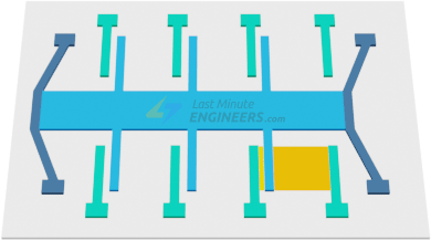

Step 2: How Does a MEMS Accelerometer Work?
A MEMS (Micro-Electro-Mechanical System) accelerometer comprises a micro-machined framework constructed atop a silicon wafer.
This framework is supported by polysilicon springs, enabling deflection when subjected to acceleration along the X, Y, and/or Z axes.
As deflection occurs, the capacitance between fixed plates and plates linked to the suspended framework alters. This variation in capacitance correlates with the acceleration along the respective axis.
The sensor interprets this capacitance shift, transforming it into an analog output voltage.
