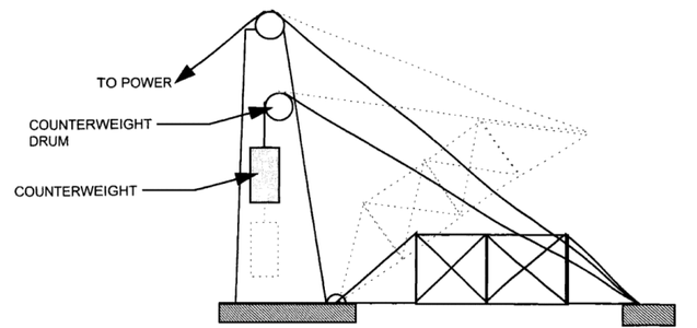

Counterweight:
Beneath the bridge deck is a heavy counterweight that balances the leaf’s weight. The counterweight is usually heavier than the leaf itself, which makes lifting easier and reduces the energy needed to operate the bridge.
Pulley System:
A pulley system helps raise and lower the bridge. Cables or chains connected to the counterweight run through pulleys and are attached to the leaf. This mechanical system helps reduce the force needed to lift the leaf, using something called "mechanical advantage."

Counterweight and Balance
The leaf pivots upward from one end, while the counterweight beneath the bridge balances the motion. The counterweight’s role is to make the leaf easier to lift by offsetting its weight. Think of it like a seesaw: when the counterweight moves down, the leaf goes up!
Pulley System
A series of pulleys guide the cables or chains connected to the counterweight. These pulleys change the direction of the force, allowing the bridge to lift more efficiently. By distributing the load across several pulleys, the system reduces the amount of energy needed to raise the leaf.

Raising the Leaf:
When the system is activated, the cables attached to the counterweight start pulling the leaf upward. As the leaf rises, the counterweight lowers, maintaining balance and ensuring a smooth lift.
Lowering the Leaf:
Once the boat has passed, the system is reversed to lower the leaf back into position. The counterweight, which helped with lifting, now assists with the controlled lowering of the leaf back onto the bridge deck.
