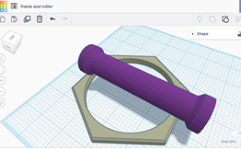

For the fraction comparison exercise to work well you will need a way to make a flat sheet of clay/ “cookie dough”. You can use the frame and roller designs provided and 3D print them. Roll clay within the frame in three different directions to make a uniform sheet of clay. Find the shapes at this link https://www.tinkercad.com/things/0BxtAVXLBjK.

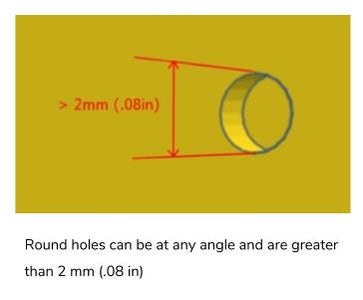

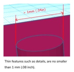

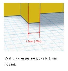

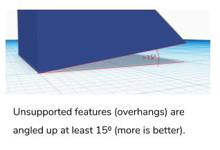

To ensure you get a quality 3D print, go through the list before tinkering and printing. (See images above)
