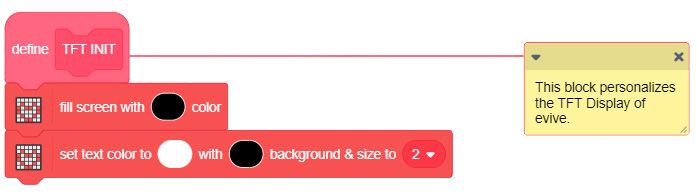

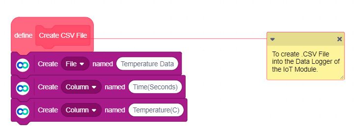

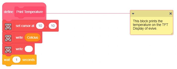

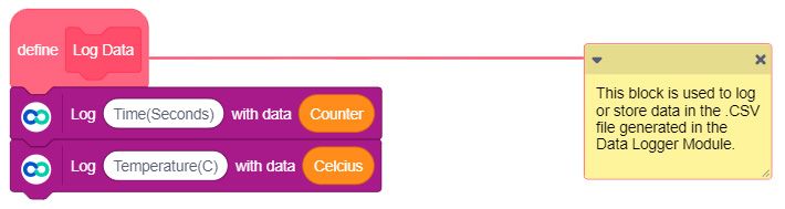

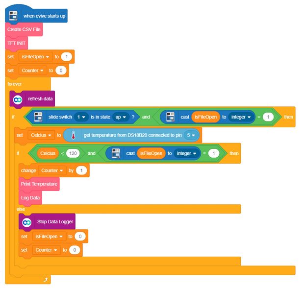

PictoBlox is a graphical programming software based on Scratch 3.0 that makes learning how to code easy and fun. It allows you to interface and control evive with your computer and even uploads code to it. You can download PictoBlox from here.
Upload the following PictoBlox script to evive.

This module stores data in real-time in a .CSV file which we can access directly on Smartphone or can send the file to the desktop.

The data logger logs data in real-time. You can see it on the screen. Any data can be monitored or seen on our Smartphone using this module.

- On heating the ice, the temperature initially increases which can be observed on evive’s TFT Display as well as on the screen of your Smartphone.
