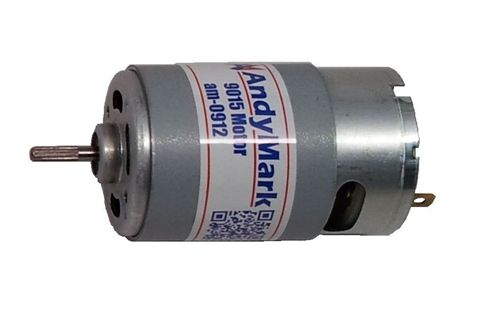

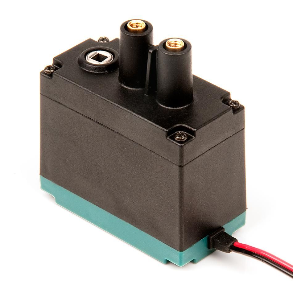

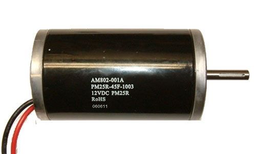

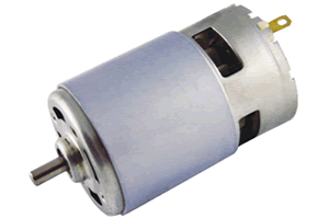

Motor Name | Picture | Notes |
RS-500 Series: AndyMark 9015 Fisher Price BaneBots RS-550 | These three motors are all very similar – the only distinguishing factors are their performance specifications. Generally, they are used in manipulators such as powering a pitching wheel, elevator, or conveyor/collector system. | |
BaneBots RS-775 | The RS-775 is a larger and more powerful version of the RS-500 series of motors. It is also commonly used for manipulators. However, the RS-775 motors have a history of developing case shorts, causing some teams to avoid using them. | |
CIM | The CIM is the largest, most powerful, and most reliable motor supplied to FRC teams. Because teams are only allowed to use 4 of them, they should be allocated to the drivetrain, where their power and reliability are most needed. | |
Denso (Window Motor) | The Window Motor is a motor that comes with a worm gearbox attached. Its high torque and low speed are often used in manipulators. Due to the worm drive, they cannot be backdriven, a capability that is desirable for some applications. | |
Vex 393 | The Vex 393 was a new motor for the 2012 season. For this reason, it has not seen much use. However, its small size and relatively high torque make it well suited for secondary functions in manipulators. As teams become more familiar with it, this motor will likely see wider use in more applications. |
