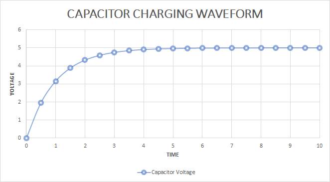

Step 4: RC Charging Circuit
The process of storing energy (when connected to a positive DC source) through the resistor until the voltage level across it reaches up to the input voltage level is called as charging of a capacitor. The circuit diagram can be drawn as:
Step 5: Charging Waveform
When we charge a capacitor, the voltage (or charge) increases with time. The graph of voltage (or charge) versus time is not linear but exponential (as shown in the figure below). After a time T =RC, the capacitor is 63% charged (or 0.63 x voltage of the battery V). T is a constant for a given capacitor and a given resistor. T is called the time constant.

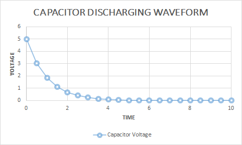

Step 6: RC Discharging Circuit
When the capacitor is fully charged and the power source is disconnected, the capacitor starts returning energy to the circuit through the resistor is called as discharging of a capacitor.
Step 7: Discharging Waveform
When we discharge a capacitor, the voltage (or charge) decreases with time. The graph of voltage (or charge) versus time is not linear but exponential (as shown in the figure below).

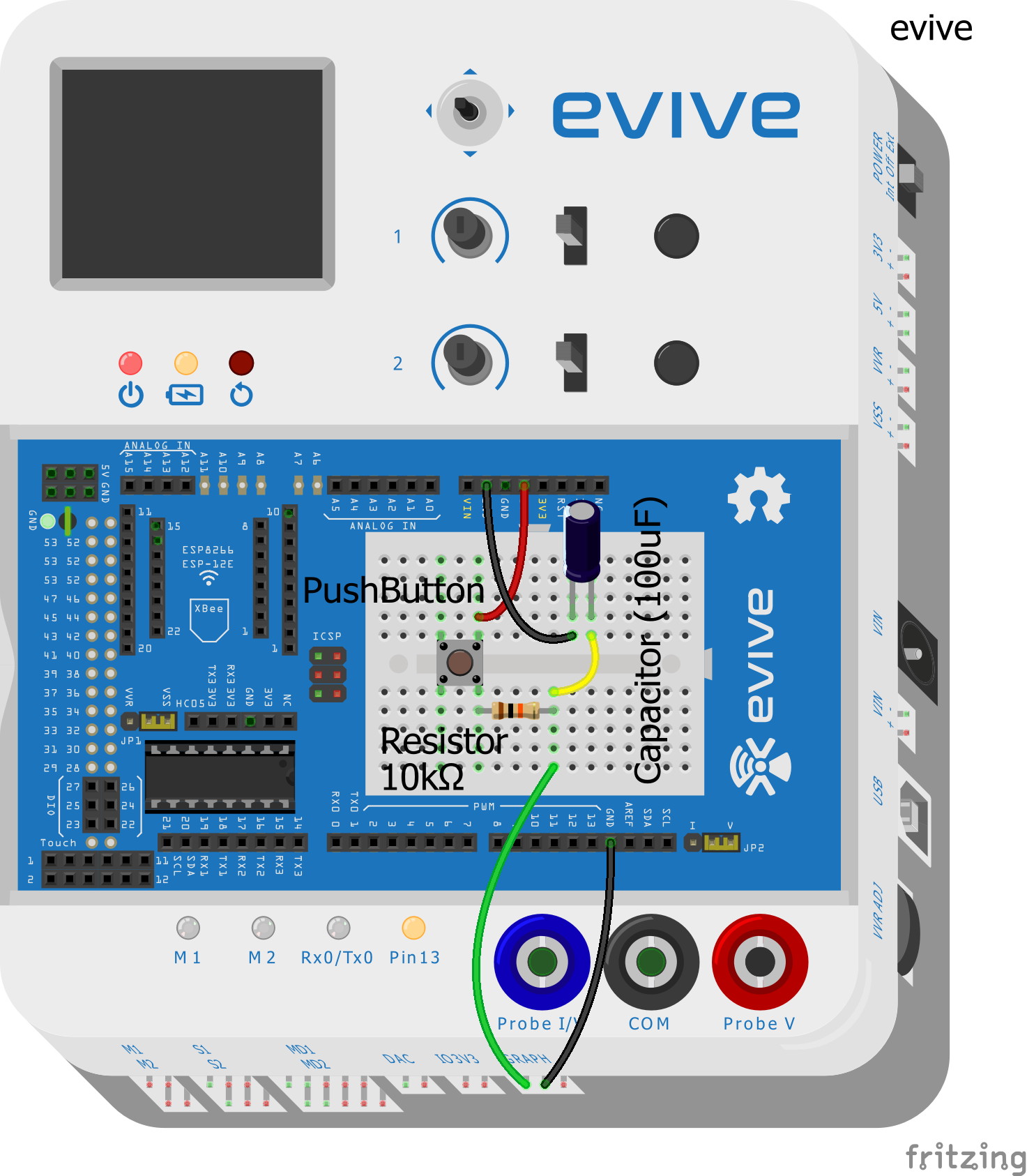

Step 8: The Connections
Make the following circuit using the resistor of value 10 kOhm and the capacitor of value 100 μF.
