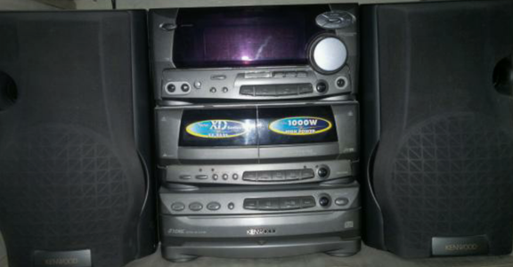

Step 1: Take Any Stereo Bluetooth Headphone
We need any stereo Bluetooth headphones. I had two years old imported from china.
Step 2: Open the Ear Cushion
All headphones must be having different ways to remove the ear sponge below which are the screws to open the headphones.
Step 3: Open the Back Panel to Access the Headphone Circuit Board
You need to remove the screws holding the backpanel of the earphones. Mostly all headphones open the side which has power on and off switch, here in this side you will get both speakers connections for left side and right side.
Step 4: Checkout the Space for the Female Stereo Scoket to Fit
Find the both R & R+ and L & L+ point on the circuit board. Also locate vacate space where your mini stereo female socket can fit. Solder three wires to mini socket, poition it properly and with solder iron make hole in the hedphone body. Clean the access melted plastic using knife/blade. Use Glue gun to hold the socket in position. I made half curve in top panel case nd half curve in bottom case so it fits around the headphone femle socket perfectly.
Step 5: The Left and Right Side Connections for Speakers
You need to find these left and right side speaker connectons and solder them to three wires from socket. you can use any one ground, and L+ & R+
Step 6: Thats How Socket Fits Into Perfectly
Your craftmenship skills are needed for perfection and clean fitting.
Step 7: Connect the Music System Via Stereo Pin Auxillary and Enjoy Music, Internet Radio
Use Auxillary input , connect to headphones, connect your any device to headphones via bluetooth. Enjoy Music streaming into your old useless music sytem via mobile, iphone, laptop, smartphones or any cheap phones too. and in this way convert your old music system into a bluetooth music system.
