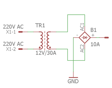

The power supply scheme includes 4 parts:
- high vlotage part;
- rectifier;
- linear volage regulator;
- front panel (with voltmeter and clamps).

Step 2: Hight Voltage Part
The high-voltage part is a toroidal transformer to which cable and power plug are connected. The cable is connected to the primary winding of the transformer(red in the image) by means of contact terminals screw, so the cable can be removed and replaced if necessary. Power plug is also connected to the cable with a screw fastening (see photo).
List of components:
- power plug 220V;
- cable 2x0.75 - 1 meter;
- double screw terminal power;
- toroidal transformer (primary 200V, secondary 12V / 30A in my case).
Step 3: Rectifier
The rectifier is built on the classic single-phase full-wave circuit, at rectifier's output there is an electrolytic capacitor of 4700uF smoothing the rectified voltage. Additionally, the unit is equipped with a 10A fuse to enhance the security of the scheme.
