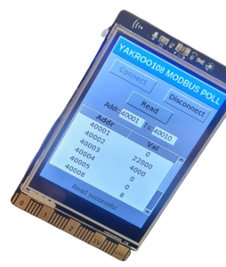

In today’s fast-paced industrial environment, real-time data access is crucial for efficient monitoring and troubleshooting. Traditional fixed monitoring setups can limit mobility and slow down response times. That’s why we’ve developed a portable Modbus Poller using RainbowLink from DFRobot and UniHIKER, combined with Python and Tkinter for a flexible and user-friendly monitoring solution.
Step 2: Design a System
System OverviewThe portable Modbus Poller integrates cutting-edge technologies to deliver a seamless and efficient monitoring experience:
- RainbowLink (DFRobot): Ensures reliable and stable Modbus communication. - UniHIKER: Handles data processing and provides an interactive touchscreen for real-time display. - Python and Tkinter: Power the software, enabling customizable polling functions and a graphical user interface (GUI) for an intuitive user experience.
With these components working together, the system can read and display real-time data from Modbus meters, offering instant insights for industrial applications.

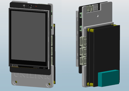

Step 5: Case & FILE 3D
