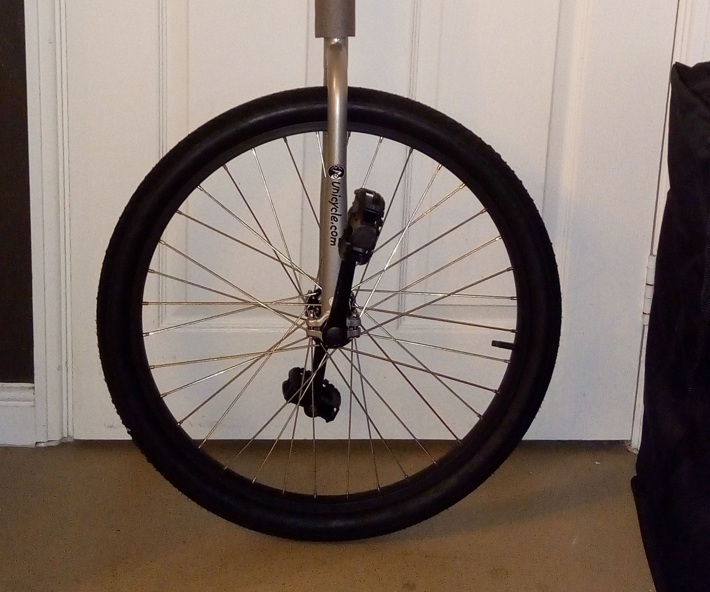

Step 1: One
Sooo - here we see the unit before install.
The handlebars themselves are from Ebay and came from a stunt scooter, the blue clamp came with it as well (cost a tenner and the clamp should have been another tenner too but by pure chance the guy selling must have not wanted it cos it was sold all in one).
The brake lever was free - we have in our family a guy who works for a cycle outlet, he builds the bikes, when folks have upgrades (brakes) the old, perfectly functional ones are taken off and thrown away - I had a chat - he let me have a couple for free, am guessing you could pop into your local and do the same, even if ya had to pay it should only be pennies
Step 2: Two
Here we see the bottom of the handles.
The bracket below the blue clamp is a wheel mount from a scooter that the local kids had thrown away in our bin storage area - the bearings were shot but wow what a great find .
So now I had handlebars and brackets to put the thing together - - but no way of mounting the bugger to my ride - when inspiration struck, I went and got an old saddle from one of our other bikes that was knocking around - popped out the seat post clamp and bugger me if it did'nt slip in sweet as a nut into the rest of the unit - badda bing on she goes onto the uni.
As to brake units, that is gonna be up to you, I found some caliper types on Ebay for £8 but if your feeling posh you might want to go for disks - calipers are great though - to fit just rill a hole through the bottom of the forks and pop em on.
sent the bike into the shop to be cabled up for the brakes to work - - sorted
