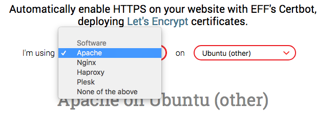

I made the changes to the new & old controller so that seems fine now. Can you tell me if I admin other Unifi APs not on my LAN should the VM controller see those APs at the site they are on, or only when I am on the LAN where those APs reside?
I also was going to try CertBot on my own but wasn't sure of the values to give it for "I'm using" (see screenshot). I chose Ubuntu other since I'm using the 16.04 you recommended.
