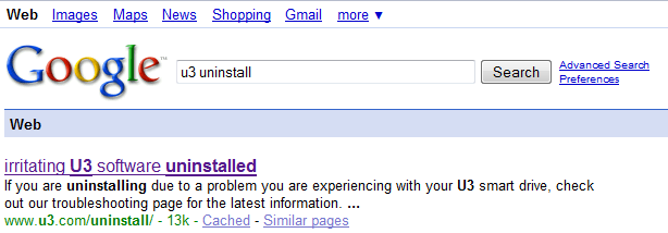

1. Google search "U3 uninstall", and click on the first link (in purple), or click here for the direct link.
2. Click on the "Remove Launchpad" link, found at the bottom of the page
3. Click "Submit and Continue"
4. Click "Download the Uninstall Application", also available here
