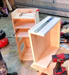

Step 1: Build the Main Body
The first step is to build the main body of the cart, which includes two side panels, a bottom and top panel, a back panel, and dividers for the drawers.
The body is designed with a tapered shape, wider at the bottom and narrower at the top, to enhance stability and prevent tipping while in motion.
I used ¾” plywood for this project. After cutting the pieces to size, I joined them with wood glue and screws. One important tip: install the drawer slides at this stage—it’s much easier to do now than later.
Step 2: Build the Drawer
The second step is to build the drawers. Each drawer is made up of two side panels, a bottom panel, a back panel, and a front panel.
Pay close attention to the drawer's width and height. I made them slightly smaller than the available space to account for the thickness of the drawer slides and any inaccuracies in my cuts.

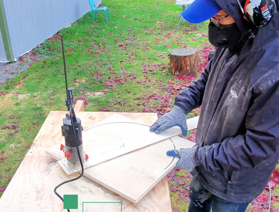

Step 4: Build the Reel - Make the Disc
I began by cutting the circular discs and preparing the dowels to connect them. I used a circle-cutting jig for precise cuts—check out my previous Instructable, on how I built it. Alternatively, you can use a jigsaw to complete this step.
With the discs ready, I drilled five evenly spaced holes at 72-degree intervals (360°/5) for the dowels.

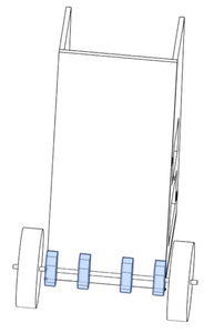

Step 9: Wheels, Axle Shaft and Wheel Holders
The two wheels and the axle shaft were purchased off-the-shelf from Amazon. To install the wheels on the cart, I made shaft holders from scrap wood, passed the shaft through the holes in these holders, attached the wheels, and mounted the holders to the back of the cart.
I used an angle grinder to cut off the excess length of the shaft and added set screw shaft collars to keep the wheels securely in place.

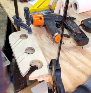

I added a couple of storage compartments on the back of the cart, along with a tool holder on the side and a dedicated nail gun holder. The nail gun holder is especially worth mentioning—I traced the shape of the nail guns onto plywood and cut it out. It turned out great, making the nail guns much easier to access.
