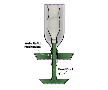

So I thought of buying a bird feeder but after looking at the available options, I was not at all satisfied with any design. Almost all bird feeders have a separate water and fodder system. I did not have enough space in my window to attach two separate dispensers. So instead I designed this "2 in 1 Food + Water dispenser for birds ", the best part is... this is literally a one of its kind design, I was not able to find such a design anywhere.
This bird feeder features an automatic water dispensing mechanism which keeps the water vessel always filled, same goes with the fodder dispenser. So you need not worry about your favorite pets going hungry : )

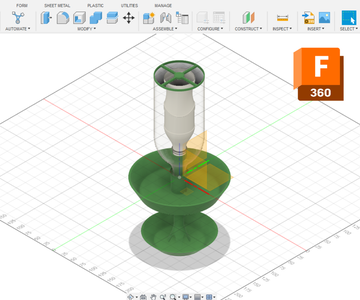

Step 1: Design
I started with designing the bird food dispenser in Fusion 360. I made sure that the designed files are easy to 3d print without any supports. The entire design has been divided into 3 parts.
  1. Water Dispenser
  2. Feeder Pipe for Fodder
  3. Fodder Dispenser

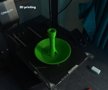

Step 2: 3D Printing
I 3D printed all files without any support. You can download the files from here : https://drive.google.com/drive/folders/1HUUY3SZqBFv7fT9KvV5YhrBqK6W_S10U?usp=sharing
You can use any slicing software to slice these files, I recommend an Infill of 15% for a standard 0.4 mm Nozzle

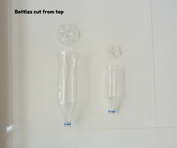

Step 3: Cut Both Bottles From Base Side
Next I cut 2 soda bottles from the base, bottle at left has a capacity of 2.5 litre and will serve as our water storage, bottle on right has a capacity of 750ml and will serve as our fodder storage.

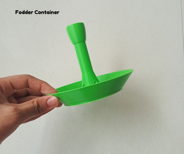

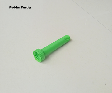

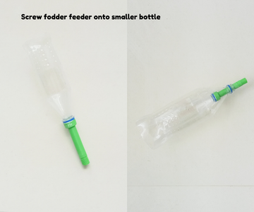

Step 4: Screw the Fodder Feeder Onto Smaller Bottle
Now let's carefully screw the fodder feeder to our smaller bottle

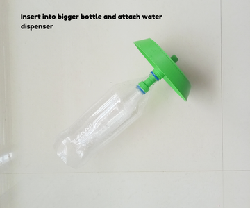

Step 5: Attach the Water Dispenser
Next we insert the smaller bottle into the larger bottle and screw in our water dispenser

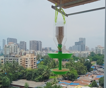

Step 7: Carefully Hook the Entire Assembly

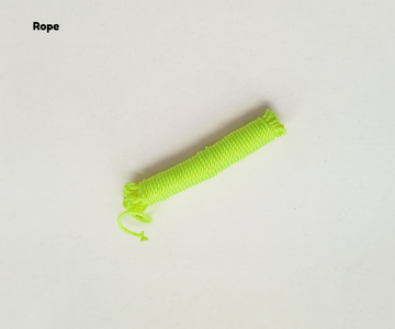

Using a suitably strong rope we will now attach the food dispenser to a strong hook. Please make sure to use thick ropes which will be visible to birds and wont possibly hurt them by tangling into their wings/feathers.

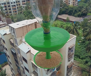

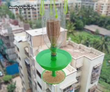

Step 8: Load and Auto Reload
With the dispenser nicely secured we can now load both food and water into their respective dispensers, birds in your vicinity now need not worry about supplies as both food and water will keep on rolling ! Thank you for reading through, please share your feedback. This is ver. 1 of the project and I will keep on improving it !!
