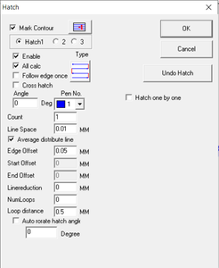

Centering. Dxf file into EzCad. Then we fill in the same way. Now it is also necessary to determine the parameters empirically. All engraving consists of two parts. First, prepare the acrylic at a slower speed. Then we apply the required text at a higher speed.
I got the best result with:
- power 50%; speed 500 mm / s; reps 5
- power 50%; speed 800 mm / s; reps 4
