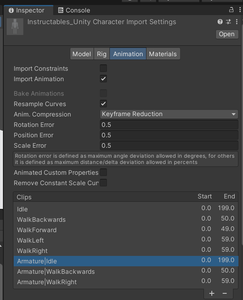

Importing the model
Click here to download the player model. This is an FBX file containing the player model and the animation data.
Drag this model into Unity and click on it. In the inspector menu, you will see that it has 4 menus. Open the Animation menu.
This model will have 3 animations with "Armature|" in front of it. You can simply delete these animations by pressing the "-" button below the clips. The animations are duplicates and will not be used in the project.
For the other animations, you will want to click on them and tick the box next to "Loop Time". This will ensure that the animation gets looped instead of only playing once.
After doing this, scroll down and click "Apply" to finalize the changes to the animations.
