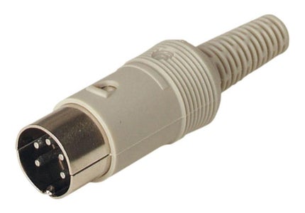

3 x 5-pole DIN plugs of the 240° variety with insulated, plastic handle. Of course you can use any other, compact 5-pole plug you have available.

The dummy plugs (3rd picture) don't need much explaining - two of them are fitted with wire bridges, the third with three wires and the screw terminal; the pin numbers correspond to the ones in the circuit diagram. However, I strongly recommend using DIN plugs with insulating plastic handles in order to reduce the risk of electric shock. I linked them mechanically using two lengths of stranded wire soldered to the internal screen (no electrical connection), simply for keeping them together.
