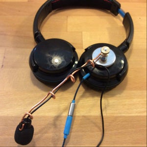

So I set out to design a way of attaching a microphone to an existing set of headphones in a way that:
- Works as well (or better!) than commercial gaming/comm headsets
- Stays in position during use, but is easily removed
- Causes no damage to my favorite headphones, completely reversible
- Looks OK/good
- Inexpensive to make ($5-10) and simple to build

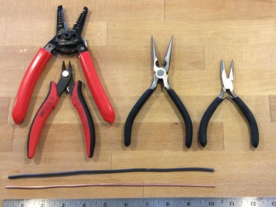

Tools
- Needle nose pliers (nice to have 2 pair of pliers to get sharper bends)
- Wire cutters
- Wire Strippers
- Clamp or vise
- 1/4" drill
- fine-tooth saw
- black spray-paint (optional)

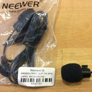

- Microphone: Neewer Lapel Microphone 5-pack these are about $1 each and do a great job

Note on the Microphone: Almost any small microphone you can attach will do here. The Neewer lapel mics sound good, have a handy little plastic tab that makes them easy to attach and they are *dog-dirt-cheap*, about $1 each on Amazon in quantities 5 and up. The cord is bit short (6') so you might need a 1/8" extension adapter if you need a longer cord. Also, it's an omnidirectional mic,*not* noise-canceling, so you won't want to use this in a super noisy environment, but it works great for Skype and gaming in most rooms .

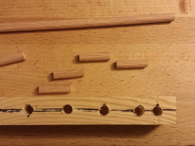

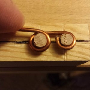

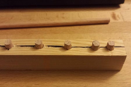

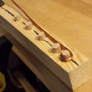

Step 2: Build Bending Jig (optional)
You don't absolutely have to make the bending jig; all the bending *can* be done by hand with only needle-nose pliers, if you have the skill and patience. However, the jig will make life a lot easier and the result will be neater. If you plan to make a few of these for yourself and/or your microphone-challenged friends, go ahead and make the jig.

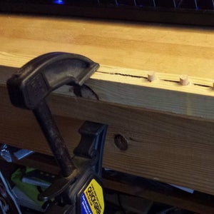

- Start with a short length of 1"x2" pine about 12" long so you can clamp it to a desk or bench.
- The dimensions are not that critical. - Draw a line along the center of the 1" side (really 3/4" if you're using standard dimensioned lumber)
- Mark 5 holes: the first pair are 1/2" apart and the remaining are 1" apart.
- You can change these dimensions to suit your taste once you understand the purpose of the jig, this is all down to preference. - Drill 1/4" holes that go about 3/4 of the way into the wood, but don't go all the way through
- Cut 5 lengths of 1/4" wooden dowel rod and place them in the holes
- there should be about 1/2" (or less) of wood sticking out of the board when the dowel rod is all the way in the hole
- if the dowels are loose, put a drop of glue in the bottom of the hole - Clamp the jig to a table or fix it in a bench vise.

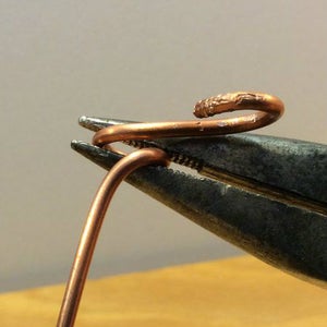

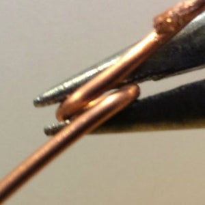

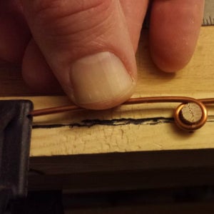

Step 3: Bend the Boom Pivot
Start by bending a 1/4" loop into one end of the bare copper wire -- this will fit over the 1/4" pin in the jig and eventually be the pivot for the boom.
- If the wire has insulation, remove it in short sections (around 2") using the wire strippers until the wire is completely bare.
- Grip the end of the wire firmly in the pliers. Bend the wire with a combination of force from your thumb and turning the pliers. Frequently re-position the pliers as the loop forms.
- Copper is pretty forgiving, so if your loop looks crazy, flatten it back out and start again, or just work with it until it's right. - Place the pivot over the end dowel in the jig (the end with closely-spaced pins).
- The reason for the close spacing is so the mic cord will be as close as possible to the existing headphone cord (assuming you put the mic boom on the same side of the headphones as the existing cord).

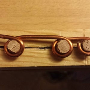

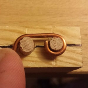

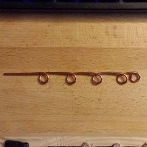

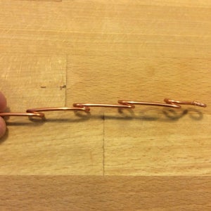

Step 4: Bend the Wire Guide Loops
Now we'll bend the loops that will hold the microphone cable in place (wire guide loops). If you're not using the jig, try to make a piece that looks like the end result photo (I built the first few prototypes this way).
- Use your fingers to do a complete wrap of copper wire around the next dowel in the jig.
- putting pressure on the wire closer to the dowel will give you a tighter bend - repeat until you have 4 wire guide loops along with the 1 pivot loop
- You should have about 1-1/2" after the last wire guide loop
- The excess wire will be used to mount the microphone
Note: The mic mount will totally depend on which microphone you plan to use. The method shown here is for a specific lapel clip mic made by Neewer (amazon link) which has a small plastic tab. For other microphones, the length of wire and the shape you bend will be up to you to figure out. For example, you might want to wrap the copper wire around the body of a microphone, which will take more material -- experiment.

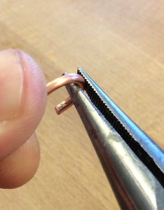

Step 5: Turn the Wire Guide Loops
Next, the wire guide loops need to be twisted by 90 degrees so they can open up and hold the microphone cable . In fact, we're actually going to grip the loop with pliers and bend the wire on either side, but the effect is the same.
For each wire guide loop (not the pivot loop):
- Grip the body of the loop firmly with a pair of pliers
- using second pair of pliers (or fingers) bend one side at a 90 degree angle to the loop body (see picture)
- do the same for the other side of the loop (so that the main stem of the boom still forms a straight line)
- repeat for all 4 wire guide loops
At the end, the boom should look more or less like a straight line. Use pliers to adjust the wire guide loops to be parallel, and straighten out the boom if necessary. Again, copper is very forgiving and with a little patience you can make it look good.

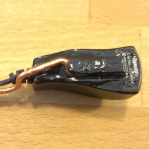

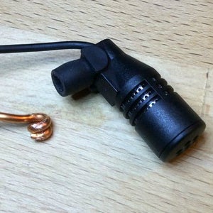

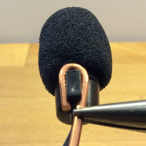

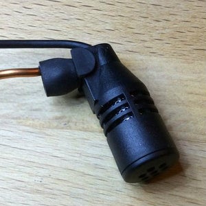

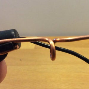

Step 6: Bend Mic Mount Loop and Attach Mic (Neewer)
Now we'll attach the Neewer lapel mic to the boom wire. If you're using a different mic, do whatever makes sense.

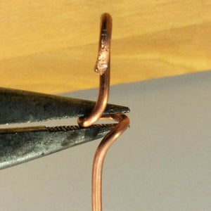

- Grip the wire on mic end of the boom (opposite the boom pivot), leaving at least 1/4" outside of the pliers
- Turn a tight "U" in the wire. There should be about 1/8" wide gap, about 1/4" long. Make sure the bend in the U isn't too sharp, we want the plastic mic tab to slide all the way in. If anything, the bend should be a little *bigger* than the width of the plastic tab.
- Test fit the mic tab and adjust the bend as required (remove the mic each time, the tab won't stand up to much abuse). The fit should be just slightly snug, do not force the tab into the slot.
- Gently squeeze the top of the "U" to capture the mic firmly
NOTE: The little plastic tab on the Neewer lapel mic could snap off easily if you put too much pressure on the wire. If you have trouble getting the fit right, then secure the mic to the boom wire with a drop of epoxy.

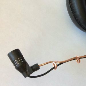

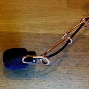

Step 7: Thread Mic Wire and Adjust Mic Angle
Now we'll thread the mic cable through the 4 wire guides and adjust the angle of the mic so that it points slightly in toward your mouth. Note that the Neewer microphone is *not* directional (picks up equally in all directions), so this is mostly for aesthetics and psychology (we tend to think we're supposed to talk into the end of the mic), so don't get too carried away.
- Thread the mic cable through the 4 wire guides. Adjust the wire guide openings if necessary.
- Adjust the mic angle by gripping the boom wire just behind the mic with the needle-nose pliers and gently turning (the other hand should be holding the boom, not the microphone!!).
- Bend a 45 degree (or so) angle using only the force from the pliers and the boom. Do NOT apply any force to the microphone by grabbing it for stability, etc. Otherwise you will break the microphone tab, it's made of plastic and is just not up to being torqued like that.
Again, you may want to put a drop of epoxy on the area where the copper captures the plastic tab on the microphone. I haven't found this necessary though.
Note: once the microphone cable is threaded through the loops, you might want to close the openings with needle-nose pliers so the cable won't come out so easily.

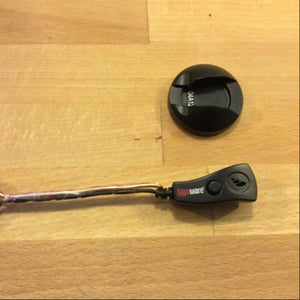

Step 8: Assemble the Boom Mount
Next, we'll assemble the mount that attaches the boom to the outside of the cup of your headphones.

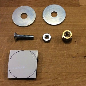

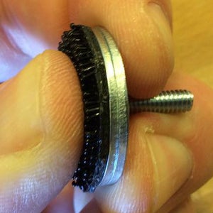

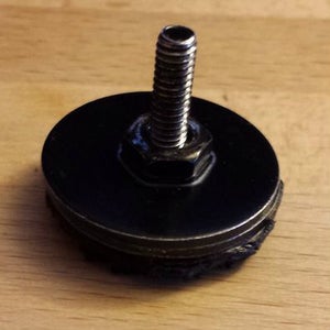

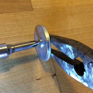

- Put the 2 fender washers together with the 8-32 x 3/4 flat-head machine screw and 8-32-nut.
- The reason for using 2 fender washers is that a single washer isn't thick enough and the nut won't tighten on the screw. You can use a smaller washer on the side with the screw threads if you prefer. The important thing is, the side with the head of the screw must be as flat as possible. - Tighten the screw and nut very well (maybe use super glue or loc-tite to be sure) because you don't want it coming loose in the future -- the head will be hidden by the fastener material and it will be a pain to re-tighten.
- Trace the outline of the 1" washer on the Scotch Extreme Fastener material and cut with scissors
- Stick the adhesive backing onto the screw-head side of the assembly and give it about 60 seconds of pressure from your thumb to ensure a good bond.
- Naturally, the washer had better be clean, dry and oil-free in order to have a good bond. - If you don't like the plain steel, a quick shot of black spray-paint on the mount will improve the looks somewhat.
- use a quick-drying flat black paint made for metal and make sure the piece is clean first
- follow common sense, doing this all well away from your great and with proper ventilation, etc.

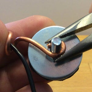

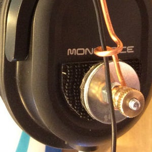

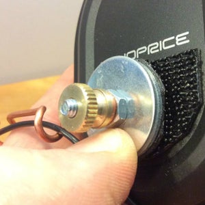

Step 9: Attach Boom to Boom Mount
Next we'll attach the boom mic assembly to the mount
- Place the boom pivot loop over the threaded screw of the boom mount.
- Take care about which way it goes onto the screw, otherwise the mic will point away from your mouth. - Adjust the loop with pliers so that the fit over the 8-32 screw is snug, but free to turn.
- Thread the knurled brass knob (or wing-nut) onto the 8-32 screw and tighten to capture the boom

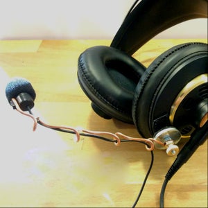

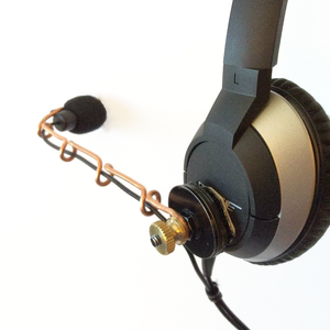

Step 11: Attach to Your Favorite Headphones
For the final step, attach the boom to your headphones.
- Press the 2 mating fastener material areas together so the mic boom mount is mounted onto the headphones
- Adjust the position of the boom by loosening the knob, positioning and re-tightening
- you can also gently bend the boom to desired position, but make sure you can still move it to an upright position when you don't want to use the mic.

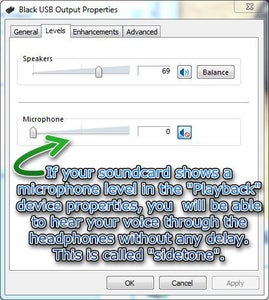

At this point, you are basically done! Plug your headphone and mic into your computer and try it out!

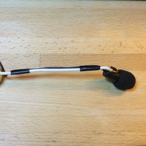

Electronics surplus houses are a great source of cheap, high quality mics too. Above (right) is a high quality car speakerphone mic from an online electronics surplus house (cost $2). The original mount on this one was a rubber boot that fit over a little plastic ball, so by bending a ball-shape in the end of the copper wire made it easy to mount to the end of the wire boom.
Finally, if you can solder, broken headsets are a great source of good microphones (and a good way to recycle)

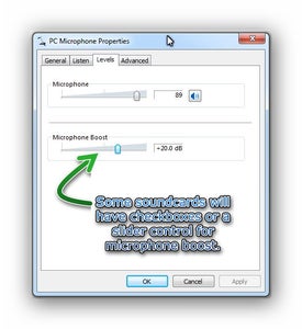

Noise-cancelling is a great thing, but there's a trade-off: this type of mic boosts low-frequencies drastically when the source is very close (like your mouth at 1"). This is called "Proximity Effect". This isn't a problem, per se, but information in speech (intelligibility) is primarily in mid-to-higher frequencies. Boosting lower frequencies can actually hinder spoken-word intelligibility (horrible to listen too as well). - Omnidirectional mics are sensitive to sounds coming from all directions, which makes them susceptible to all kinds of noise in the room -- keys clicking, paper rattling, fans, etc. While picking up room noise is generally bad, omni mics are not subject to proximity effect and maintain their frequency response regardless of distance
So by placing an omni mic very close to your mouth (off to the side, never in front!), your voice will be much louder than the other sounds in the room and there's no unwanted bass boost.
So which one is better? Try them for yourself and see, but in general if the environment is especially noisy, unidirectional is preferred. For a reasonably quiet room, I like the sound of an omni better. Bottom line, both can sound very good.

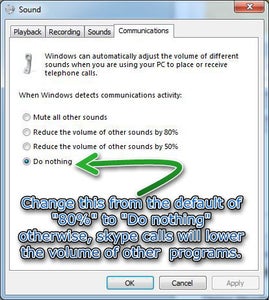

Step 14: Final Tips

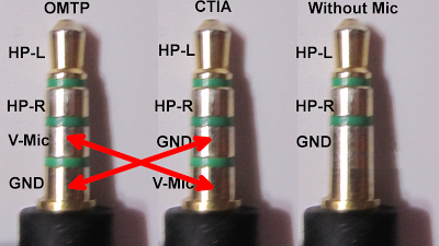

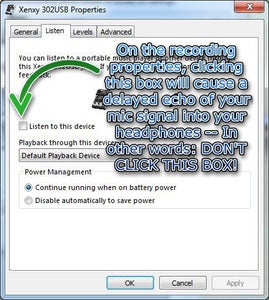

Using Headset with a Smartphone, Tablet, PS4, Xbox One, Wii U or Laptop with a single audio connector
If you want to use your headset with a device that has a only single 3.5mm (1/8") for stereo and microphone, then you need an adapter that converts the standard PC 3.5mm headphone and mic plug into a 3.5mm TRRS plug (TRRS=tip ring ring sleeve, i.e. 4 barrels or contacts). The one in the first picture is from Radio Shack, but there are many online like this one, that are more of a short cable style.
Take care, because there are 2 standards for these smartphone plugs: The older OMTP standard used on Nokia and older Android phones, and the newer CTIA, used by Apple, newer Android phones and newer laptops with only one audio port.
All of the next-gen gaming consoles (PS4, Xbox One, Wii U) use the CTIA version to plug into the controllers (Xbox One requires an adapter) so if you have something that works with Apple devices, it will work on the consoles too. If you have a device with the other standard (OMTP), just look for an adapter with that pin arrangement.
It's totally possible to use this with older consoles also, but requires different adapters (lots of instructables on this, or ask).
Cable Management
If you don't plan to remove the mic boom very often, you might want to cut 1" lengths of twist-tie material and wrap it around the 2 cables near the boom, and possibly at intervals down the length of the wire (see picture). Electricians tape or duct tape would work too, but they both leave sticky residue on cables. Gaffer tape is a better alternative if you have it around, but it's a bit pricey.

Here's how to adjust your microphone level on Windows 7:
- Right-click on the speaker icon in the lower right systray and choose recording devices (or playback, they open the same dialog).
- The Sound devices dialog will appear.
- You'll see a list similar to mine in the first dialog picture above, but the number of devices, names and icons will be different -- that's ok, I have extra devices so I rename them and change the icons. - In the "Recording" tab, double left-click on the device your mic is connected to (or right-click and select 'Properties').
- the properties dialog will appear for that microphone recording device - In the Properties dialog, select the "Levels" tab and you'll see a slider to adjust the gain.
- start with this on about 75% and test how you sound by making a skype test call, or recording yourself with a program like Audacity, etc. - Gain Boost: Some sound cards have sliders or check-boxes that boost the gain (amplification level) of the microphone. Gain can affect the quality of the sound, where level will just change the volume.
- Try the different settings and see what sounds best, you might have to change level after changing a gain setting.
- Boosting the gain too much can lead to excess room noise, distortion, or "bleedover" where you may hear a delayed echo of your own voice
- With too little gain, you won't be loud enough, even on 100% level - AGC: Some sound cards may have a check-box for AGC (automatic gain control) which tries to keep your voice output at a constant level. Sometimes it works well, other times not so much. Again, experiment.
Other Hints for Better Microphone/Headset Sound on Windows:
- Sound Reduction on Phone call: Turn off the "Reduce sound when Windows detects a telephone call" feature. This is located in the "Communications" tab of the sound device dialog (right-click speaker icon, select playback or recording devices). By default, Windows 7 "helpfully" turns down the volume of other programs down by 80% when it detect a "phone call", e.g. using a program like Skype.
- Sidetone/Mic Monitoring: old-school telephone handsets feed a little bit of your own voice into the earphone so that you won't feel the need to shout. This is called sidetone, and is different from a delayed echo you might hear otherwise. Some soundcards support sidetone, most don't.
- Look in your *Playback* device properties (not *recording* as you might expect). If you see a slider for a microphone level underneath the speaker level (see picture above), then your sound card supports sidetone, and increasing the mic level will give you some idea that you're talking without annoying delay or echo.
- USB Audio Adapters using the CM108 chipset support sidetone. They sound good and are inexpensive as well. - Listen to This Device: another way to temporarily check your mic voice quality (besides Skype or Audacity) is to use the "Listen to this Device" box on the "Listen" tab in the "Recording Device" properties dialog (see last picture above). If you check this box you'll hear what you sound like, but with an annoying delay. Still, it's useful for a quick check.
- check the Listen box, apply, and see how you sound,
- Adjust gain, level, AGC, etc until you're satisfied
- Finally uncheck the box and apply.
Note: many folks mistake the "Listen" box for a way to get sidetone, but the delay is too long to tolerate. The sound card hardware must support sidetone so that there's no delay. The way Windows puts the sidetone setting under "Playback devices" is somewhat confusing.
