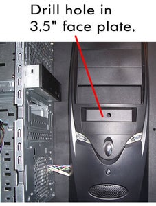

Step 2: Locate Where to Drill Hole for IR Receiver
Here is my PC, and where I'm going to drill the hole for the IR window.

Step 4: Open Up the PC
I removed 4 screws from the back of the PC so that I would have access to the motherboard. This also gives me access to the tabs for removing the front faceplate so that I can drill the hole and mount the IR switch module...
Step 5: Drill Hole for the IR Detector
Started with 1/8" drill, then 1/4", then 3/8". Stepping up the drill bit sizes makes for a hole with a smooth edge. I left the 3.5" plate in the main faceplate while drilling so that the part would be easier to hold steady. Be cautious and safe when drilling anything, especially small parts with relatively large bits.

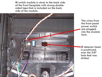

Step 6: Connect IR Switch Module to Motherboard
Unplug the PC's front panel switch from the motherboard, and plug in the module's two pin connector in its place.
Step 7: Mount the IR Switch Module
There is strong double sided tape on the back of the module that mounts it to the inside of the back of the front faceplate. The module should be mounted so that the IR detector can "see" out of the hole that was drilled.
At this point, I also connect the front panel power switch to the IR switch module. This allows me to control the PC power either manually or with the IR remote control.

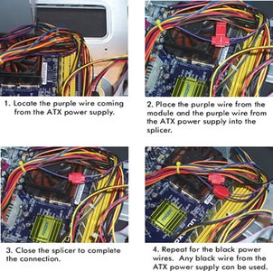

Step 8: Connect Power Wires to IR Switch Module
Now it's time to connect the module to the ATX power supply. This is done with the included splicers.
At first I was wondering how the IR switch could turn the PC on if the PC was off in the first place. The answer is that ATX power supplies have a standby line (purple wire coming out the the ATX power supply) that provides a small amount of power to the system at all times (assuming that the AC line is plugged in and the power supply switch on the back is turned on.)
