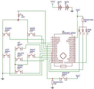

Step 3: Setting Up the Main Circuit

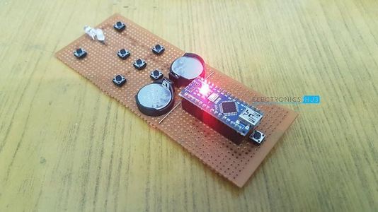

- Firstly wire up the circuit according to this new diagram. we have used here prototyping board, however you can design your own PCB.
- Now starting from code, take out the list of decoded signals and write in to the designated place in the code according to the remote type.
- Once done check for the transmitted signal by testing in front of that appliance by watching its response.
- For powering up the remote 9v battery is used. Li-ion rechargeable batteries can also be used. also 3D printed case for the circuits can be made so that it looks professional.
