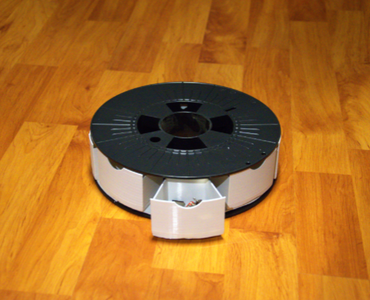

I love 3D printing! It's so practical, it allows anyone to go from a simple idea to a prototype in just a few hours! I've been doing it for 6 years now, and I've already emptied a few spools... So I wondered if we couldn't do something with them... Searching on the Internet, I came across a number of design proposals that turned them into organizers. That's exactly what I wanted, because as well as 3D, I'm interested in electronics and programming, so I've got lots of little components to store. However, when I wanted to test these solutions, I ran into a problem: all the designs are for different coil sizes and it's not easy to find your way around, especially if, like me, you have coils of different sizes. So I created a document on the online CAD software: OnShape, a universal drawer model! By following this Instructables, you'll all be able to print your own organizer system for empty 3D filament spool, no matter what the dimensions of your spool. And you can even choose the number of drawers you want.

In the bottom left-hand corner, you'll see a list of the different parts, on “Base 1” then on “Drawer 1”, right-click and export to STL. It's not necessary to export every part, as all drawers are patterns.
Step 4: Slicing and 3D Printing
Use 3D slicing software to print your parts in 3D. You need 2 bases and the right number of drawers. Personally, I've chosen to print in PLA, but any hard filament will do. For the parameters, I trust you ;) However, if any of you are interested in mine, there's a preview in one of the images!
Step 5: Stick and Assemble
All that's left is to glue the bases to one side of the spool. Super Glue works perfectly, and I'd recommend using pliers to make sure everything sticks. Finally, to assemble the drawers, place them on top of their rails. Depending on the tolerances of your printer, you may need to lightly sand the back of the drawer rail.
