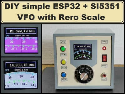

   A variable frequency oscillator (VFO) is an oscillator whose frequency can be tuned (i.e., varied) over some range. It is a necessary component in any tunable radio transmitter or receiver, and controls the frequency to which the radio is tuned. This time I will show you how to make a VFO that covers the range from 100 KHz to 160 MHz and uses a minimum number of components.
 The selected frequency is displayed on a beautifully designed retro scale in the style of ham radios from the previous century. About 2 years ago, In one of my previous videos (https://www.youtube.com/watch?v=DSxK0jwMZw4&t=535s) I made a small shortwave radio receiver with this VFO, but the current version has additional functions for changing the tuning step, as well as storing frequencies. These options drastically simplify the operation of the device.

   Now let's see how the device works in reality.  Immediately after switching on, the start frequency that is previously defined in the code appears on the screen. Turning the rotary encoder changes the frequency. The tuning step, and thus the scale rotation speed, is controlled by the two buttons, and ranges from 10 Hertz to 1 Megahertz. With the the rotary encoder button we memorize the current frequency, and after the next power-on of the device, it will be the initial frequency. The oscillator also has the ability to memorize previously defined frequencies in the code, that we can call up with the MEM button.
For the first few megahertz the signal has an approximately rectangular shape. Then by increasing the frequency, the shape of the signal becomes sinusoidal. Even at the highest frequencies, the shape is almost triangular and the amplitude of the signal decreases significantly.
