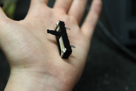

2. Potentiometer.
I'm using a slider. One with a knob works just as fine.

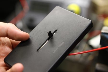

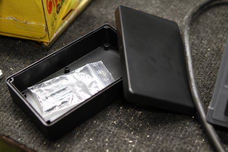

Step 2: Preparing the Box.
First, we will prepare the box.
We need 6 holes for this particular design. It's possible with fewer, but it requires some homework :)
I put 4 on the short-sides and two on the longside.
The top two will be where you hook up the power.
The bottom two will be where you connect the LED's.
And the two on the side will be the signals going in. (Speaker wires from the stereo or amplifier)

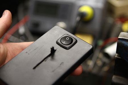

After the holes are drilled, you either drill a hole on the lid for a potentiometer (knob version) or carve a longer hole for a kind like mine.
Aswell as a hole fitting for the on-off switch.
Make sure your potentiometer fits and slides without anything obscuring the way.
When done, glue it in place or use screws.

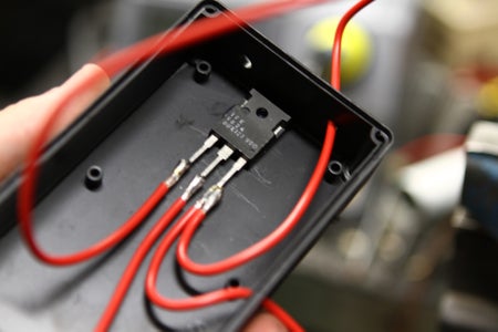

Step 3: The Transistor.
Now we are attaching some wires to this intruiging piece of IC.
But before i go into serious B,C,E - writing, here is some info on how it works.
The transistor is like an amplifier.
It uses a small current to activate a bigger one.
When the small current gets bigger, the bigger one gets even bigger.
In this case, the small current is from my speaker-wires. When the base-lines roll it pushes more voltage through the wires, and this is what will make our "bigger" current to make the leds flash, or shine brighter.
This is why it's better to use a transistor for flashing with music, rather than just hooking it up straight to the speakercables.
I Measured my subwoofers Voltage-range, and it goes from 0V -> 12+V and if your LED's are made for 3V, you can imagine the poof they do. Since here we have a voltage-roof.
The transistor consists of three legs (can be more)
The Base
The Emitter
The Collector.
B,C,E.
The current wants to flow through from the Collector to the emitter, but it can't unless we have voltage on the base.
Imagine a switch on a wire. You press on it with your finger, you then control the current inside the wires to flow, or stop.
Now a transistor is smaller. So imagine your finger is replaced with a current. (this way we can make it smaller)
The current turns the switch on. But instead of just I/O, you can push harder, and get more flow, and vice verca :)
When you have it pressed at max, you will get what you have it hooked up to. 12V-car battery, or maybe a 3V-battery? (if you have it directly to your subwoofers lines, there aren't really a max)
Just typing this makes my head spin, so let's continue!

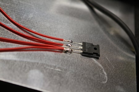

My transistors pins from left to right are, Base - Collector - Emitter.
So solder one wire to each pin, and two wires to the emitter (think of it as the pin that emits the power, this will be connected later to the negative pool of the battery, and signal.)
When you are done with the soldering, glue it to the inside of the box.

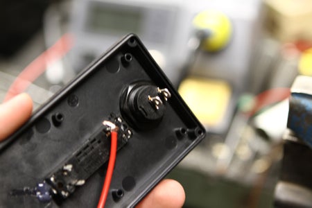

Step 4: Wiring It All.
Here is where it gets VERY messy.
So follow these simple steps and you should make this work like a charm!
You can use hot-glue to fix your wires to the holes so they can last a few tugs and don't break.
- First cable goes through the box from top left corner to the I/O switch (this is the cable you put on the + Pool on the battery)
- From the switch out the bottom left hole. Cut it here, this is where you connect the LED.
- The collectors wire you put through the bottom right hole. (Middle pin) This is where you connect the LED's other wire.
- Drag one wire from the emittor (right pin) out through the top right hole, this will be the negative pool on the battery or powersource.
- Drag the other wire out on the side of the box from the emittor. This will be the negative for the audiosource. (though it's AC "there is no negative")
- Final wire is from the base (left pin) this goes to the potentiometer.
- Then from the potentiometer out through the side hole.

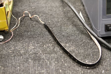

Step 5: Done!
Alright! You are done!
It looks .. like a crab, but it will get the work done! .. But yes, how does it work?
You are in luck, it's universal.
first you connect your LED's. (I'll use 12V-leds in this case) to the bottom wires.
Then you connect the powersource which in this case is max 12V DC.
Lastly connect the audiosource, and turn it on, crank up the volume!!!
Now you will notice it almost only shines brightly.
Mix with the potentiometer (Sensitivity stick) and watch it become more awesome :)
