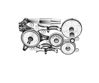

Step 1: Download the STL Files
The following STL file represents the complete assembly:
  • Assembly (complete).stl (not suitable for 3D-printing)
Two complete sets of STL-files are supplied as full build-plates as follows:
  • All parts_200x200x115_mm_build_volume.stl (fits most RepRap 3D-printers)
  • All_parts_MakerBot_Replicator_2_and_2X.stl (fits most MakerBot 3D-printers)
All individual parts are supplied as follows:
  • Bearing wheel.stl
  • Centerring and locking cone.stl
  • Guide-tube holder and filament filter.stl
  • Spool spindle.stl
  • Spool-less coil holder (attachment).stl
  • Spool-less coil holder (main).stl
  • Tripod base.stl
