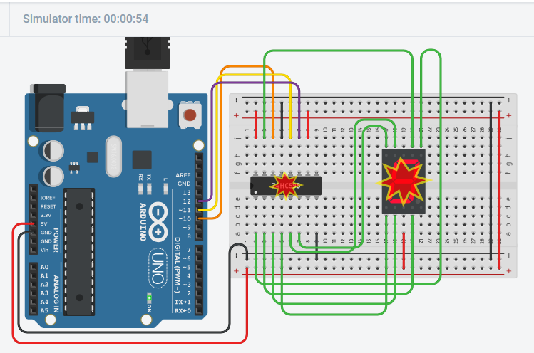

Tinkercad circuits have an excellent feature. It shows you if more than the rated current flows through the circuit elements. In the following circuit, I connected a seven segment display directly to a shift register without any resistor. It is not safe for the register even for the seven segment display and both can be burned by this connection. Tinkercad shows the fact by the red stars.

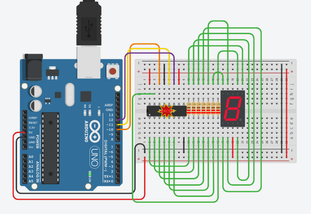

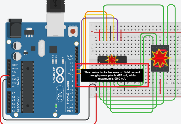

In the following circuit, I added one 180 ohm resistor to each segment of the LED. About 14.5mA current flows through each segment of the display which is save for the display. But from the simulation, it can be seen that this resistance value is not safe for the IC. The maximum current capacity of the shift register is 50mA. So, the IC is safe up to three on segment of the display (14.5 x 3 = 43.5mA). If more than three segments become on the IC can be burned (e.g. 14.5 x 4 = 58mA). Most of the maker doesn't give attention to this fact. They calculate the resistor value considering the display only.
But if they simulate the circuit in the Tinkercad the chance of making this mistake goes to zero. Because Tinkercad will alert you by showing the red star.
You can observe the situation on hovering the mouse cursor on the star like the figure shown below.

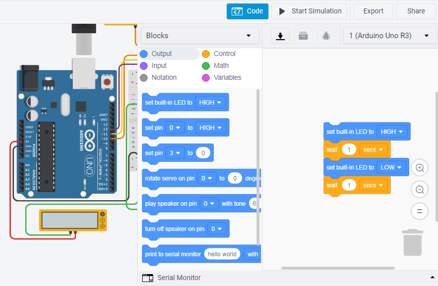

One of the interesting and useful features of Tinkercad circuit is that it has a code editor and you can write a program for Arduino and ESP8266 directly from its environment. You can also develop a program using graphical environment by selecting Block mode. It is very helpful for the maker & hobbyist who have no programming experience.
It has also a built-in Debugger from where you can debug your code. The debugger will help you to identify the bug (error) in your code and correct (debug) it.
Tinkercad circuit also has the serial monitor and you can monitor the sensor value and debug you circuit very easily. The following circuit was used to test PIR & ultrasonic sensor and on=bserve the data in serial monitor.

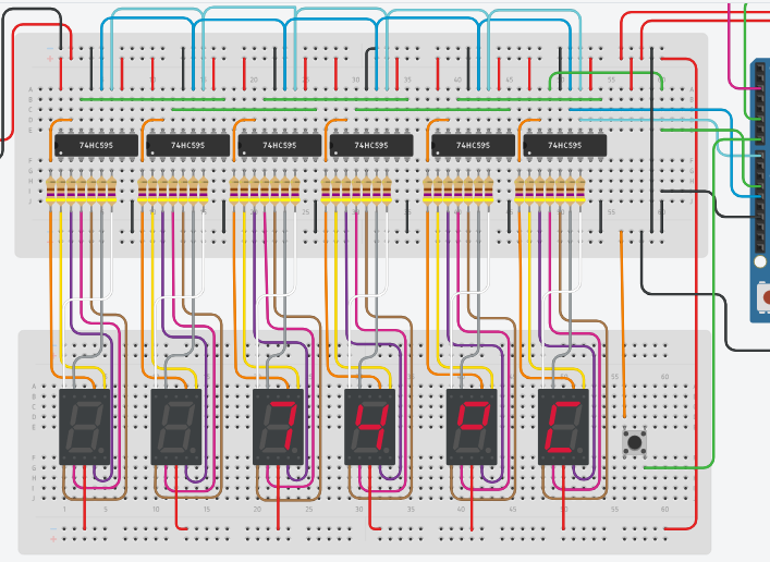

Step 4: Simulation of Big and Complex Circuit (Clock With Thermometer & Lux Meter)

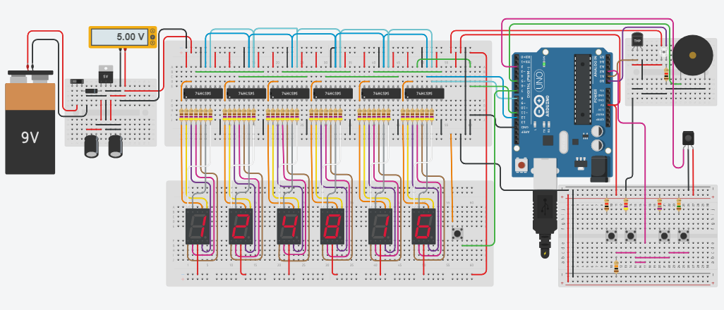

In Tinkercad you can simulate any complex circuit before making it practically. It can save you valuable time. The chance of making mistake in a complex circuit is very big. If you test it in Tinkercad first it can be very effective because you are knowing either your circuit and program will work or not. From the result, you can also modify and update your circuit according to your requirement.
I have simulated a complex circuit in Tinkercad and it is a clock circuit with thermometer and lux meter. The circuit is powered from a 9V battery with a 5V regulator. Six, seven segment display is used to display the time with hour, minute and second. Four buttons using single analog input is used to adjust the time. A buzzer is connected to set the alarm. LM35 IC is used to display sense the temperature of the environment. An ambient light sensor is used to measure the lux.
A digital button switch is used to Arduino pin #7. This button switch is used to change the option. By default, it shows the time or works in clock mode. For the first press, it shows temperature and shows lux level for the second press.
