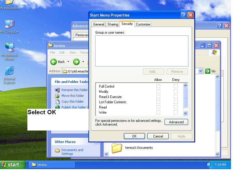

Step 2: Select Security
Select Security

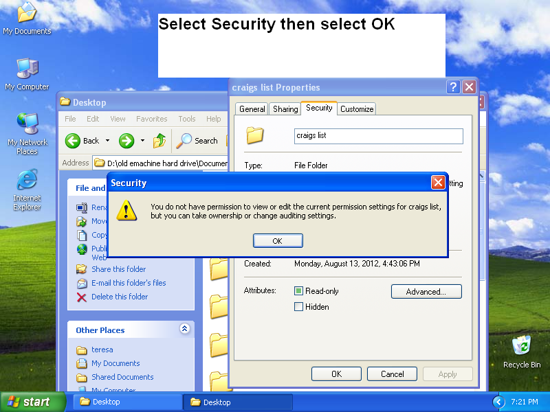

(you will get a security message)
Select OK
Select OK
