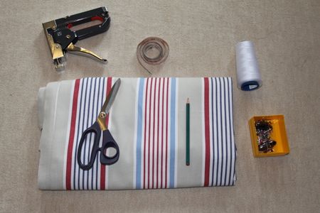

Step 1: Requirements
Material of your choice - 2Meters 30 cm
Thread to match
Scissors
Top pins
Tape (in case you need)
Pencil/Marker
Paper
Sewing machine (not included in the Picture)
Screw driver (forgot to include)
Stapler
Loads of staple pins

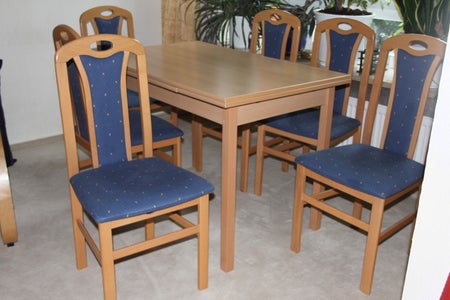

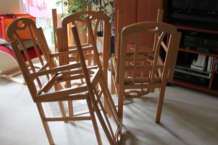

Step 2: Old Dining Table Chairs
Step 3: Removing

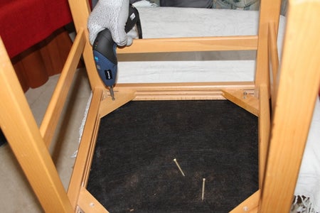

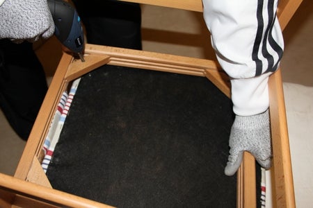

Turn the chair upside down and unscrew the four nails attached on all four sides.
Once the screw nails are out the seat can be taken out.The back rest is just inserted on to the two slots on both ends.Give a tap on the back rest and it comes out.All six chairs are removed.

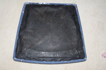

See the patches! We have used this for almost 10 years.This was a gift for us when we moved to the new flat. oh!! blue is not my colour. Any way we used it for such a long time .Now it is high time to get new ones.

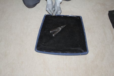

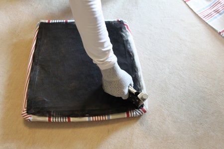

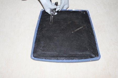

Now get the staples out from the back of the seat. My hubby helped me to remove the staples one by one carefully, as the lining was very thin and there are chances of the lining getting damaged.

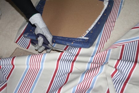

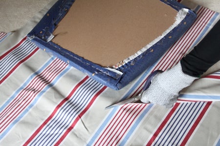

Since I am good in sewing I don't need to measure and mark before cutting the material.I can do it off hand,so I laid the material on the carpet wrong side facing upwards.I did not want to remove the old blue cover as the work will be too much.So I cleaned up the old seat and placed the seat on the material wrong side facing upwards.
I was a bit disappointed with my hubby for not taking a full photo.I realized it only when I was uploading the pictures.Too late as every thing is fixed already .Any way you could see half of it.
I left around 2inches on all for sides for stapling and cut the material around.

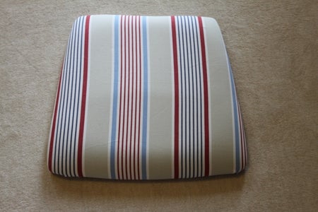

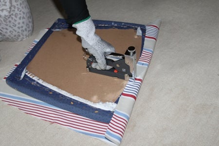

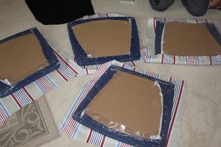

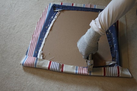

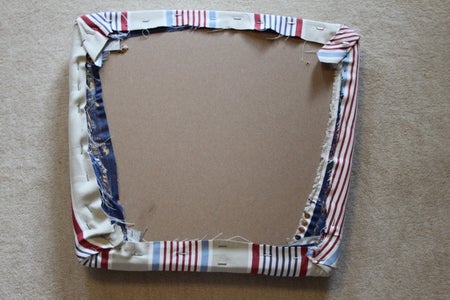

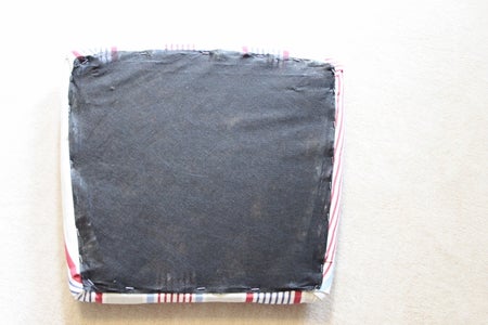

I couldn't do much of stapling because it was a bit hard to press.I don't have that amount of energy.My hubby also helped me to do the stapling.First we did side A and then had to pull the material up tight and staple side B.Then again pull on side C to staple.Finally pull the material on side D and staple to complete the seat. If the material is not pulled it will be not be even on the right side.This method will make the material on top of the seat smooth and taught.
Next step is to turn the seat on the wrong side and staple the lining carefully.This gives a good finish even though it is on the wrong side.

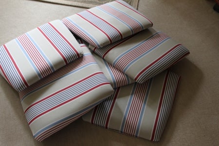

Step 7: All Six Seats Are Ready!!
I managed to take the lines the same way on all six seats.

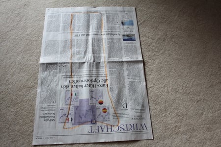

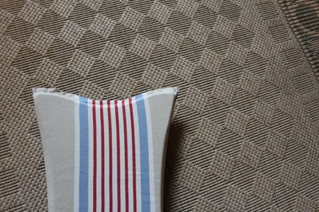

Ha! no spots or patches on the resting piece.I cleaned it up and placed it on a piece of paper.
I marked it a round with a felt pen.Then cut along the marked line on the block.

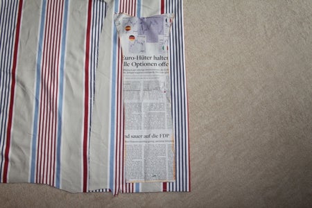

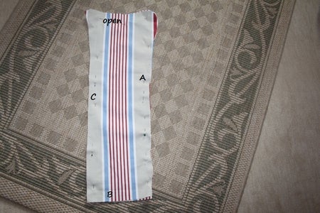

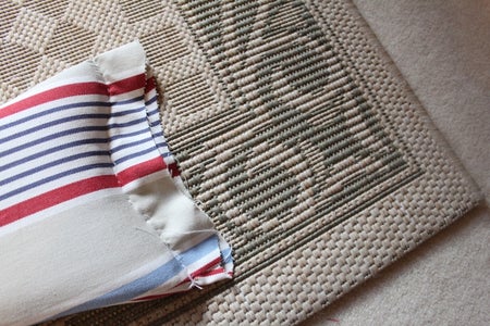

Fold the material in to two,the wrong side facing out ,place the paper block and pin it. Then cut out the material leaving about 1-1 1/2 inches on all sides for sewing allowances.
Sew on all three sides marked A B &C

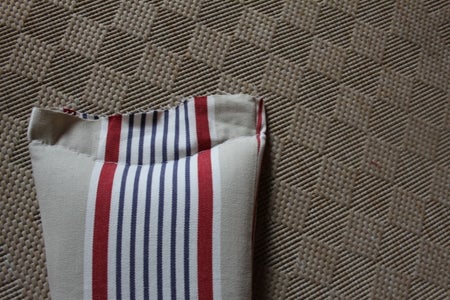

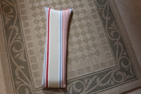

Turn inside out and slip in the piece,and again pull the sewn cover very well,so that there are no gathers and it gives an even finish..Now hand sew the open side.Cut the excess material away.Leave only 1/4 inches

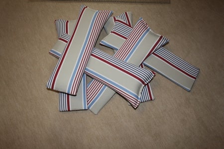

Step 9: All Six Back Rest Completed

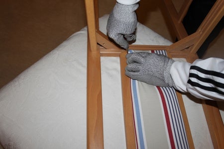

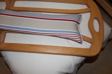

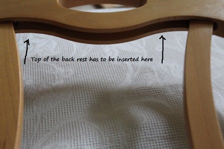

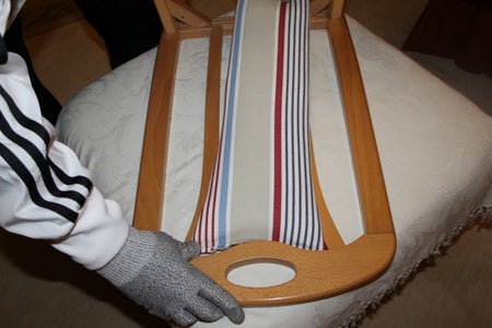

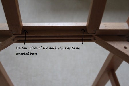

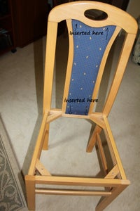

Pic 1 : This is where the curvy side of the back rest has to be inserted. Looking at the rest of the pictures you can follow up as how it is assembled. First I inserted the top piece and then the bottom piece on to the chair .Since I did not remove the old blue cover ,it was a bit too thick and my hubby had to insert it with a small pocket knife.
Step 11: Assembling the Seat

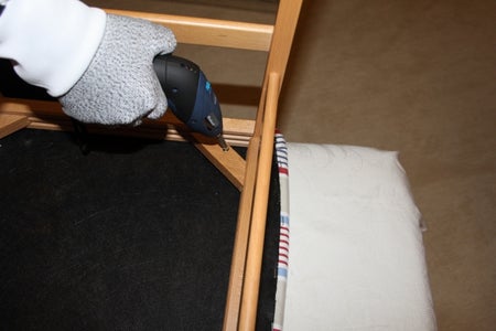

It is very easy.Just turn the chair up side down ,place the seat underneath and screw all four nails in the slot.When you do this the back rest will automatically get tightened.
