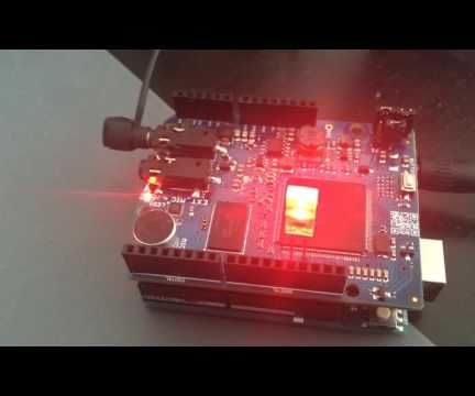

Step 1: Mount the MOVI Shield
Disconnect all power and USB cables from your Arduino board and connect the MOVI shield onto it, making sure all the pins align correctly. If you see two pins sticking out, you have an older board. You can operate MOVI but you should read Appendix A of the User Manual first to see if you need to set a jumper.
Connect an external speaker or a headset to the Audio Out. Audio Out is labeled “HEADPHONES” and is the audio jack further away from the onboard microphone, closer to the Arduino headers. You can only connect headphone impedance speakers, such as active speakers for laptops and cell phones.
Connect an LED to Arduino header pin D13 (+) and GND (-). It's better to use a resistor but it'll work without long enough...
Step 2: Power On
Connect the external power supply to the Arduino board and switch it on. After about 2 seconds, you should see MOVI’s LED (close to microphone) blinking with increasing frequency. The speakers will say “MOVI is booting”. Eventually the LED will stop blinking and just be constantly on. This indicates MOVI is ready. If the LED does not go on at all, please turn off the power and check with the user manual. If, by the time, the LED has become steady red, you didn’t hear anything, please check your speakers/headset and the connection.
