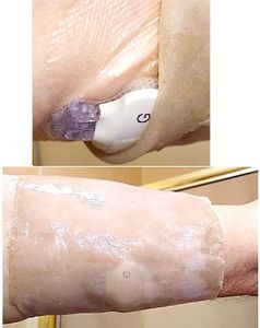

A friend was talking about wearing a Constant Glucose Monitor and how much trouble it was taking a shower, never mind swimming, because he had to wear a water tight patch and tape it to his arm. With every shower more tape and plastic covering was used and thrown away. I asked him for more details and suggested a reusable Watertight Arm Band. He liked my idea and this is what I made.
Postscript: He let me know that by using this Watertight Arm Band, he is saving $10+ a month in less supplies. He is very satisfied.

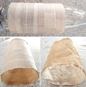

1) Measure smallest diameter of the arm and choose how long.
2) Then cut from the hosiery leg.
3) Stretch hosiery over bottle or something close to the diameter of your arm, smaller diameter is better.
4) Cover the hosiery with tape then remove from bottle.
5) Turn taped hosiery inside out, slide band over the bottle with the taped side facing the bottle.
6) Cover the hosier with Silicone let cure, repeat with 2-3 thin layers.
7) Remove Watertight Arm Band when fully cured (about 24 hrs) and remove tape.
8) Place Watertight Arm Band over device and arm when bathing or swimming.
The Silicone will be on the outside when all is said and done.

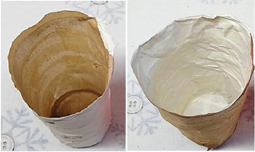

Here is a Silicone Collapsible Cup, I made this because I wanted to have one. It is easy to travel with because it takes up very little space. It can be rolled up and stored in a pocket. I don't have to worry about breaking it and it always returns to the original shape.

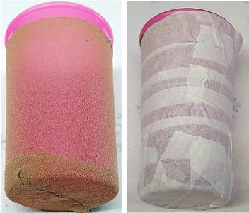

These instructions are similar to the Watertight Arm Band, in that you are creating your form with tape then turning it inside out. Then covering the pantyhose with Silicone. The main difference is the Silicone will be on the inside when all is said and done. Where as the Watertight Arm Band has the Silicone on the outside.
1) Cut foot off pantyhose.
2) Stretch hosiery over cup.
3) Cover the hosiery with tape.
4) Remove from cup and turn taped hosiery inside out and replace on cup (taped side facing in).
5) Cover the hosiery with thin layer of Silicone, let cure and repeat with 2-3 thin layers.
6) Remove Collapsible Cup when fully cured (about 24 hrs).
7) Remove tape and turn Silicone to the inside.
Enjoy your Collapsible Cup, add water, drink, fold or roll and store.

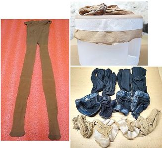

Here is an alternative method to DIY Thigh High Stockings. I have not seen anyone who has made everyday light weight pantyhose into Thigh High Stockings.

1) Apply tape over pantyhose while on leg.
2) Remove pantyhose and cut above tape.
3) Turn inside out and tape below the measuring line. This tape line will give a straight Silicone border when removed.
4) Apply thin layer of Silicone on the measuring line, let cure (about 24 hrs).
5) Remove tape from Thigh High Stockings.
Wear Thigh High Stockings as needed.

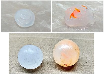

Here is something just for fun. When I made the prototype and showed the kids, they thought it was great, cool, awesome. They asked if they could play with it, I gave it to them. When I asked for it back they couldn't find it. Oh well. This is Version 2 and V3 which is colored, just for fun.
Materials:
100% Silicone (does not need to be Food or Medical grade)
Gloves
Dish Soap (helps to keep Silicone from sticking to gloves)
Plastic bag
1) Apply Silicone upon a material with little surface tension (I used a plastic Cheez It bag), enough for a small ball, let cure for 12-15 min.
2) Make circular rolling motion with gloved hands (either Silicone rolled on gloved hands or rolled on plastic material).
3) When round and firm let fully cure (about 24 hrs).
Amaze yours and your kid’s friends with your DIY Silicone Bouncy Ball
