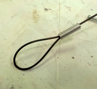

Step 2: Cable Ends and Loops
Bike cables can be a pain if you have to cut the end off but with a small pop rivet tube, you can put an end on it so it says in one piece and doesn't stab you in the finger. Just cut off the swage on the end and insert it into your pop rivet tube and give it a tap with a hammer on the back of the vice.
If you can't hit it with a hammer electrical terminal crimpers work almost as well
Also great for motorbike carburettors if you have to make a new cable, the little end fits perfectly in the carburettor slide.
If you need to make a loop just use a bigger rivet. Great if you want to make fishing lures or snares, also great for emergency repairs or throttle cables on cars and go-karts.
You might wonder how strong is that loop? Very strong!
