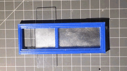

The MSS consists of a plastic 3D printed frame with two partitions and a transparent floor and roof separated but a short distance to attract magnetic dust to the roof using a strong magnet and move it to a collecting partition.
ASSEMBLY INSTRUCTIONS
  • 3D print the STL file containing the MSS frame shown in Figure 1. The frame size has been calculated for slides with a standard size of 75x25x1.4 mm.
  • Cut a metalized paper card surface to have the exact size of the slide. We have used one obtained from chocolate packaging.
  • Add the bottom slide to the bottom of the frame, fitting the slide to the guide of the frame. Use gloves and be careful not to force the slide to avoid cutting yourself if it breaks. Add the aluminated slide on the bottom and stick both with some tape to keep them firm. The mirrored surface will help see the material attracted by the magnet.
  • Add the slide on the top of the frame. This slide should be able to slide as shown in Figure 2.
  • Add the smaller slide using the later slit. We have used a small 61x16x1.4 mm slide usually provided in educational microscopes. This slide will remove good specimens for further microscopic analysis and collection.

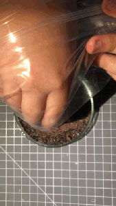

Finding micrometeorites is a dirty business. You should find a lofty, relatively undisturbed place where dust, possibly only from space, can accumulate. A flat roof will be perfect, as micrometeorites can stay in place after falling on it and be easily picked up. We, however, could only choose a dry-out rain gutter where sediment has accumulated from trickling down the roof. It would be best to use a strong neodymium magnet in a plastic bag to collect as much dust as possible (see Figure and video for the procedure). Try collecting from different places to increase that chance as much as possible. Plenty of videos and websites dedicated to this topic illustrate the collection process.

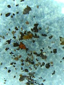

Now it is time to test your patience and luck find! You can use a handheld or an ordinary stereo microscope to scan the sieved-out dust meticulously. Micrometeorites are usually spherical as it was shaped in this form, as by entering the Earth's atmosphere at high speed, it partially melts. However, they can also have other shapes. An excellent book on this topic is given as a reference, and many youtube videos and specialized websites help you with this citizen scientist hobby (see References).

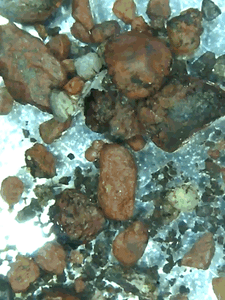

Finding micrometeorites is challenging, and it requires a lot of patience. We have started to give a try to our device collecting some dust from the house room and gutter pipe but so far, with little success. A lot of the metallic material comes from fireworks specks of dust or the material in the roof tiles (see pictures).
