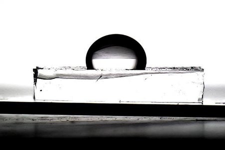

Step 2: Deposit the Drop
Carefully dispense a single drop of the liquid onto the substrate using the pipette or dropper, taking note of the initial drop diameter and volume.

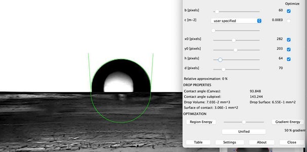

Step 4: Observe and Record the Drop's Metamorphosis
Monitor the drop's shape, size, and behaviour by capturing videos. Take screenshots and analyse images using ImageJ software(national health Institute)
Step 5: Calculate the Evaporation Rate
Measure the drop's diameter or volume at regular intervals (Δt) to calculate the evaporation rate (dV/dt), which will reveal the dynamics of the process.
