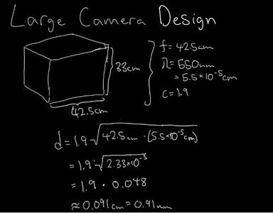

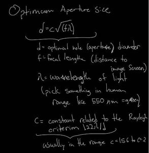

Using f-stop calculations as well as the box dimensions from the materials above, calculate the optimal pin size for each camera The general formula for optimal aperture size is shown above.

  2. Using aperture formula, determine the optimal aperture diameter for the corresponding focal length (box length)

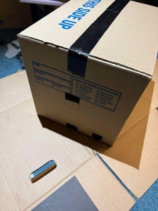

  3. Cut black poster board to fit inside the faces of the large box (the entire inside of box should be black)
  4. Use a glue stick to temporarily secure poster board pieces to inner faces
  5. Apply 2 x 5cm pieces of black tape to the corners. There should be 16 pieces of tape holding the poster board in place, two in each corner)
  6. Assemble the top and bottom of the box using tape, ensuring all gaps and holes are sealed. For the center gap on each face, use excess poster board to cover the openings before securing everything with tape for a light-tight seal.

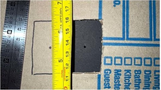

  7. Cut a 5cm x 5cm inch hole in one of the end faces (small sides) of the box. This will act as the first aperture stage
  8. Use a large sewing needle to poke the hole according to the sized calculated using the corresponding focal length (0.91mm in this case)

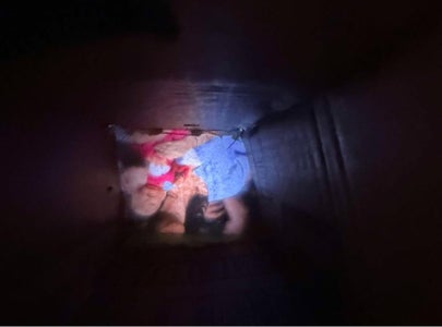

  9. With a smartphone, take a photo of the inside of the box when in front of a bright environment with a subject in the background

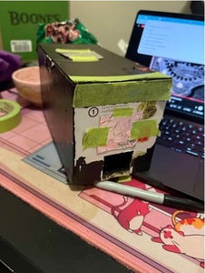

  1. Clear a working space and collect the required materials.

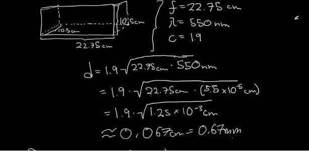

  2. Using the f-stop calculation, determine the optimal aperture diameter for the corresponding focal length (box length).
  3. Paint the inside of the box black. Apply multiple coats if necessary.
  4. Using black tape, assemble the top and bottom of the box. Cover any holes with several layers of black tape to block out light.
  5. Cut a 5 x 5 cm hole in one of the end faces (small sides) of the box. This will serve as the first aperture stage.

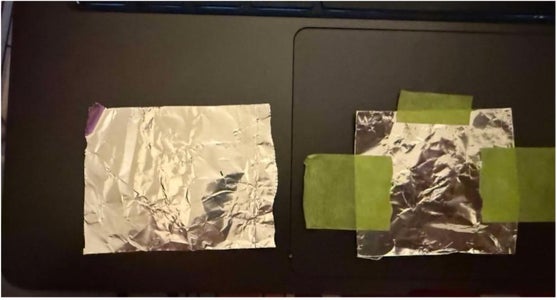

  6. On a hard surface, poke two small pinholes in two separate 6 x 6 cm pieces of aluminum foil. First, create a 0.3 mm pinhole, then create the specified 0.67 mm pinhole. Use a ruler with millimeter markings for precision (see Figures 5 and 6).
  7. Tape the 6 x 6 cm piece of aluminum foil to the inside of the box, ensuring the pinhole is centered (or use poster board as shown in Figure 6).
  8. Cut a hole large enough to fit a smartphone camera.
  9. Take a video of the reverse image on the screen while in a bright environment with nearby subjects.

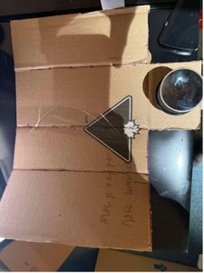

  2. Fit the plano lens inside a toilet paper role liner (inside cardboard), use tape to increase diameter if necessary.
  3. Mark cut points on cardboard according to Figure 9
  4. Cut out main housing.
  5. Cut the solid lines and fold the lines with arrows in the direction of the fold as seen in Figure 9.
  6. Mark cut points according to Figure 10 for focal point slider (FPS)
  7. Using the toilet paper liner as a trace, cut out a hole in the end of the main housing
  8. Insert lens piece (with liner) into the hole on main house, wrap o-ring on the both the inside and outside parts of the lens piece to hold it in place
  9. Cut out FPS
  10. Slide FPS cut out into main housing to secure while taping
  11. Tape with black tap, cover any holes on taped edge

Large Camera Obscura
Observations:
  1. Brighter images than small camera
  2. Same detail if not more than small camera as certain focuss distance
  3. Easer to position smartphone and capture a subject
  4. The pinhole size was almost the exact same size as calculated for clearest image. In the experiment we used two different pinholes one too small and one at 0.91mm to prove that
  5. Harder to focus, depth of view was less than small camera
Small Camera Obscura
Observations :
  1. Much dimmer image
  2. Slightly sharper in correct angles
  3. Much harder to position smartphone and capture a subject
  4. Pinhole appeared to be close to the same width as calculated for a clear image

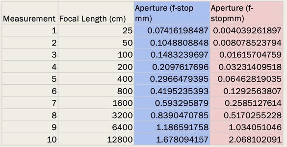

The large format pinhole camera provided a better picture overall. There was greater contrast due to the larger amount of light entering through the aperture. The larger pinhole seemed to have a clear image. However, it was harder to position the camera as the depth of view was less than the small camera. This should be expected as the diffraction effects are less as the pinhole size increases in diameter. This is the purpose for the general formula to approximate the optimal aperture hole size (as seen in the chart above). I have also included a chart to show the different between scaling the pinhole size proportionally vs using f-stop calculation. You can see that the maginute of diameter of holes increases at almost double the rate if one does not calculate it using d=c*sqrt(f*lambda).
From these findings we can see that large cameras require a larger aperture size. This affects brightness while lowering the depth of the field of view. The angular resolution (theta min) gets better as the size of the aperture increased due to the lowering of diffraction.
