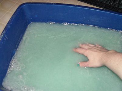

Step 5: Mix
Pour your pretty (and possibly delicious smelling) pulp into your plastic tub.
Add water until you have 4-5 inches of depth to work in.
Mix with your hand to ensure pulp is floating throughout. It may feel so fine and light that you'll question whether there's enough pulp in there. Trust me, there is.

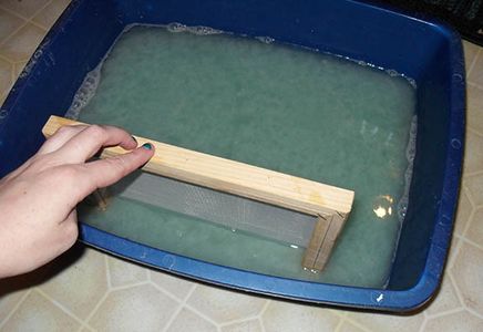

Step 6: Screen
Insert your screen into the water vertically, on edge.
Tilt and push your screen into the water, as if you are trying to get under it. This helps decrease trapped air under your fine screen and allows your pulp to flow evenly over the top.
Swish your screen gently back and forth under the surface of the water. You want to make sure pulp is flowing around so it can be captured.
Using both hands (one of mine was on the camera) life the screen out of the water, laying flat. There should be a fine sheet of your pulp on the screen.
If you didn't get an even coating on your first try, that's ok! Just re-dip your screen, gently shake it clean, and re-lift until you are happy with the result.
Repeat with multiple screens, or save pulp mix for later.

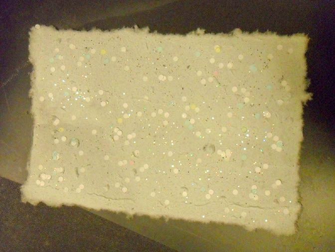

Step 9: Experiment!
This basic Green-Craft process can be customized a variety of ways. Experiment with different colors of paper, scents, or adding textural elements such has leaves and dried herbs, glitter, or paper circles from your hole puncher to use like confetti. Your final product can be made into stationary, gift tags, sculptural paper art and so much more. The project possibilities are endless...and anything is better than a pile of junk mail under your coffee table!
