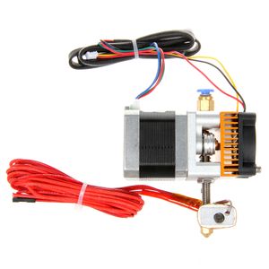

Step 1: 3D Printer Extruder Basics
The image above is an 3d printer Extruder. This is a Geeetech MK8 extruder and is not used in the UP Plus 2 printer. The upper part provides feeding the filament. It contains a stepper motor, a feeder part and a cooling fan.
The lower part is used to melt the filament. After which it's extruded through the nozzle. The heating takes place using a heat block. This is the aluminium part at the lower part. This heat block houses 3 parts: The nozzle, a heat element and a temperature sensor. The heat element and temperature sensor are connected to the red wires.
The heat element is turned on until the temperature sensor returns a certain value (270 degreed celcius). At this point the heat element is turned off. And will be turned on when the temperature is below a certain value.

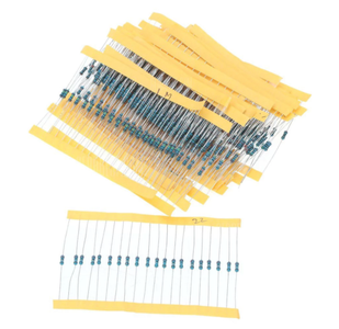

  • 1 x Prototype board
  • 1 x 10 Ohm resistor
  • 10 x 1 Ohm resistor

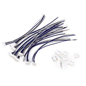

  • 1 x JST Connector set

Step 3: JST Connector
After removing the protective cover, the extruders connector becomes visible. It's located at the left side, with red an blue marked wires.
Measuring the resistance between the wires gives 6.7 Ohm for the red wires and 107.7 Ohm for the blue wires. The value of 6.7 ohm translates to below minus 200 degrees celcius. And the value of 107.7 Ohm translates to 20 degrees celcius.

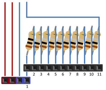

The red wires are connected to the heat element. We have to add an resistor to the blue wires, to 'alter' the resistance of the temperature sensor.
Placing the JST PH 4-Pin cable to the connector, shows the wire which need an additional resistor (grey, most right).
Step 4: Multiple Resistors
It is possible to place a single resistor (10 Ohm) between the grey wire (most right in the previous step). This will reduce the temperature with 28 degrees to 242 degrees celcius. But this makes it impossible to alter the temperature.
The image shows 10 resistors placed in series. The first (left) resistor has a value of 10 Ohm, the others have a resistance of 1 Ohm. The total resistance is 19 Ohm. This results in a default temperature of 217 degrees celcius.
The resistors can be bridged with a dupont wire. This reduces the total resistance. Placing a wire between 11 and 6 reduces the resistance with 5 Ohm. And increases the temperature to 231 degrees celcius.

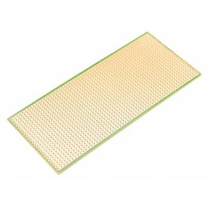

Step 5: Prototype Board
I've made the first version using a double sided prototype board.
Start with the resistors. I've soldered these on the upper side of the board. This makes it posible to bend the wires on the solder-side, before soldering alle wires together.
Secondly: Solder the pin headers, bend the wires and solder them together in a straight line. Like in the image from the previous step.
Finally solder the jst-connector and the wires.
Note: It would have been more easy to use a prototype board with lines.

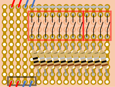

Step 7: Dip Switches
This step describes some improvements to the prototype. At first, the dupont-wire is replaced by dip-switches. Secondly, the jst-connector is replaced by long pin headers. And is now placed at the back of the print plate (second image). This provides better placement on the printer. And finaly I've used a different type of prototype board. This makes it easyer to solder.
This version is slightly different than the prototype. It has less temperature settings:
 switch  | Resistance | Temp ABS | Temp PLA
   1     |         -  |    270.0 |    200,0
   2     |    10 Ohm  |    242,5 |    173,0
   3     |    11 Ohm  |    238,7 |    170,3
   4     |    12 Ohm  |    189,3 |    167,6
   5     |    13 Ohm  |    234,2 |    164,9
   6     |    14 Ohm  |    231,5 |    162,2
   7     |    15 Ohm  |    228,7 |    159,5
   8     |    16 Ohm  |    226,0 |    156,8
   9     |    17 Ohm  |    223,2 |    154,1
  10     |    18 Ohm  |    220,5 |    151,4
  11     |    19 Ohm  |    217,7 |    148,7
  12     |    20 Ohm  |    215,0 |    147,0
Note: Switch 1 is near the connector.
Placing a switch in the ON-position shortens the 'resistance-path'. And the lowest switch-number determines the temperature setting. Eg, switch 5 and 6 gives the temperature for switch number 5 (234 degrees celcius with ABS).

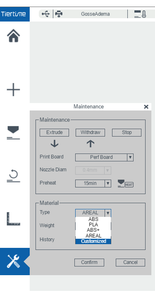

A full reinstall of one of my laptops required met to download the Up software. And the Tiertime download page showed different software for my printer:
  • Up studio for windows (beta)
  • Up 2.1.8 for windows
I was curious about the difference between the Studio and regular version. And I downloaded the latest studio version from Github. The new software requires registration at Tiertime, but It has a big advantage over the regular software.
The maintenance menu allows to add customized filament. I've created a filament type AREAL, with a nozzle temperature of 230 degrees and a platform temperature of 80 degrees. All without modifying the printer.
You can choose to turn off the data collection function: Click on your account name, press 'Settings' on the right upper corner. And turn off the privacy policy.
