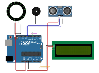

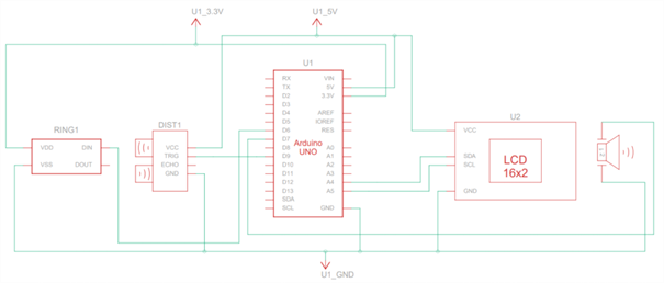

Step 1: Connect the Arduino Parts
First, the Arduino components need to be connected. Follow the provided schematics carefully for detailed guidance. Below is a description of the necessary connections. Note that the prototype shield must first be placed directly onto the Arduino before making any further connections.
Ultrasonic sensor:
  1. VCC: 5V
  2. TRIG: D10
  3. ECHO: D9
  4. GND: GND
Buzzer:
  1. (-) pin: GND
  2. (+) pin: D7
Neopixel ring:
  1. GND: GND
  2. VCC: 3.3V
  3. DIN: D6
  4. DOUT: don't connect this pin
LCD I2C screen:
  1. GND: GND
  2. VCC: 5V
  3. SDA: A4
  4. SCL: A5
