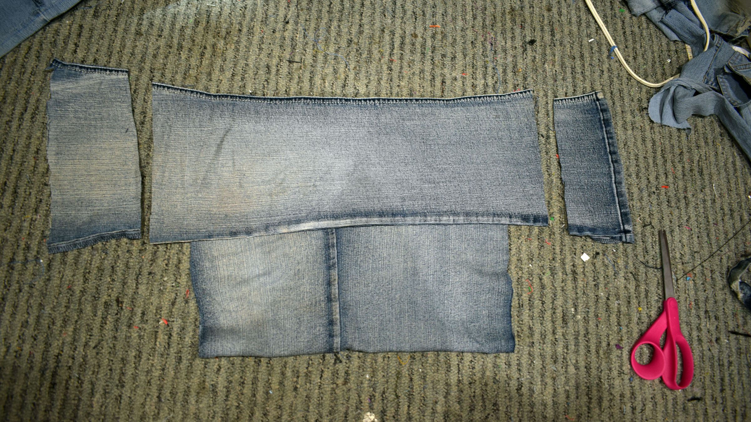

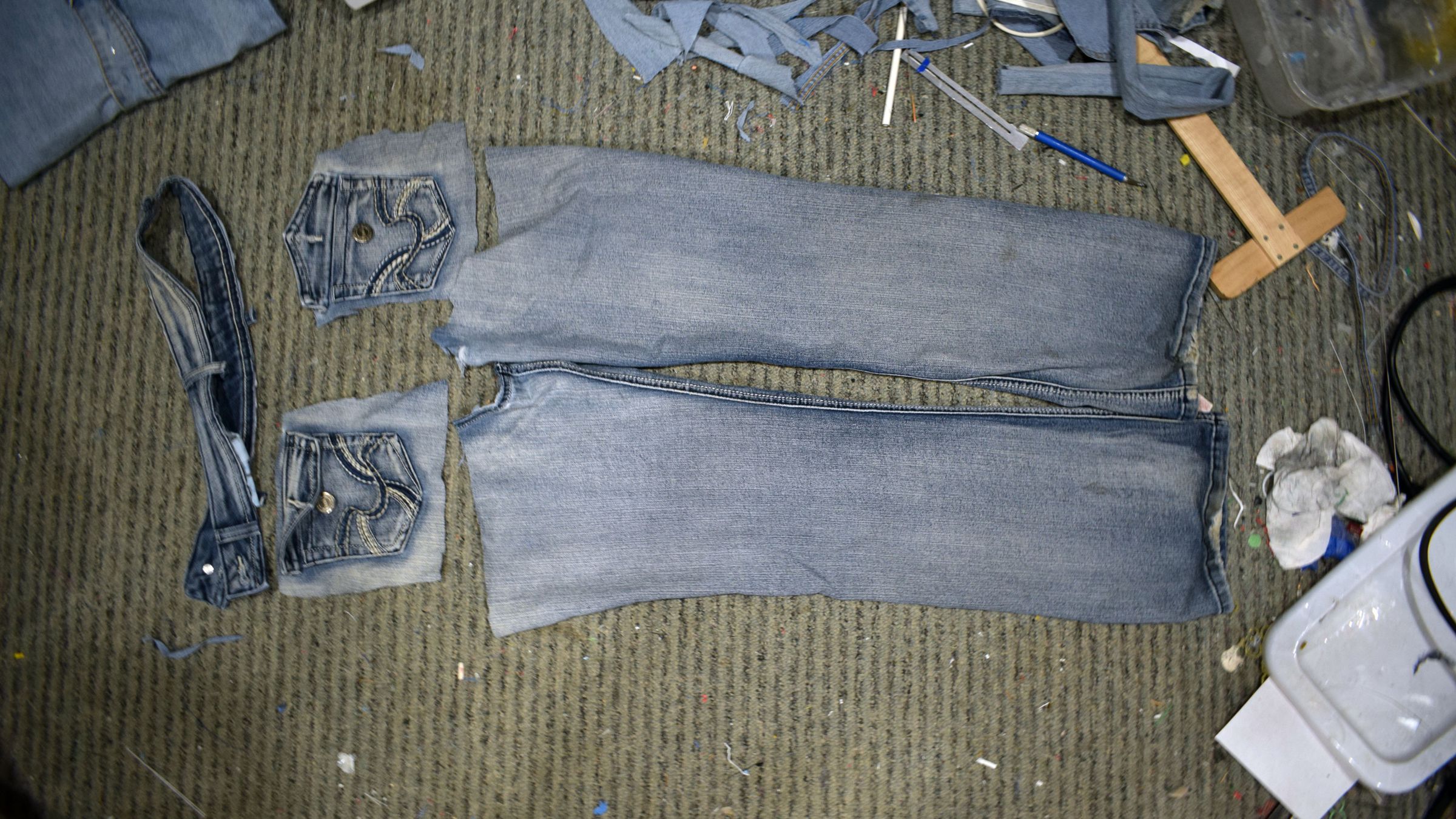

Step 1: Prep Work
1. Cut the belt off the waist of the jeans.
2. Cut the pant legs off about 1 inch below the back pockets of the jeans.
3. Cut out back pockets.

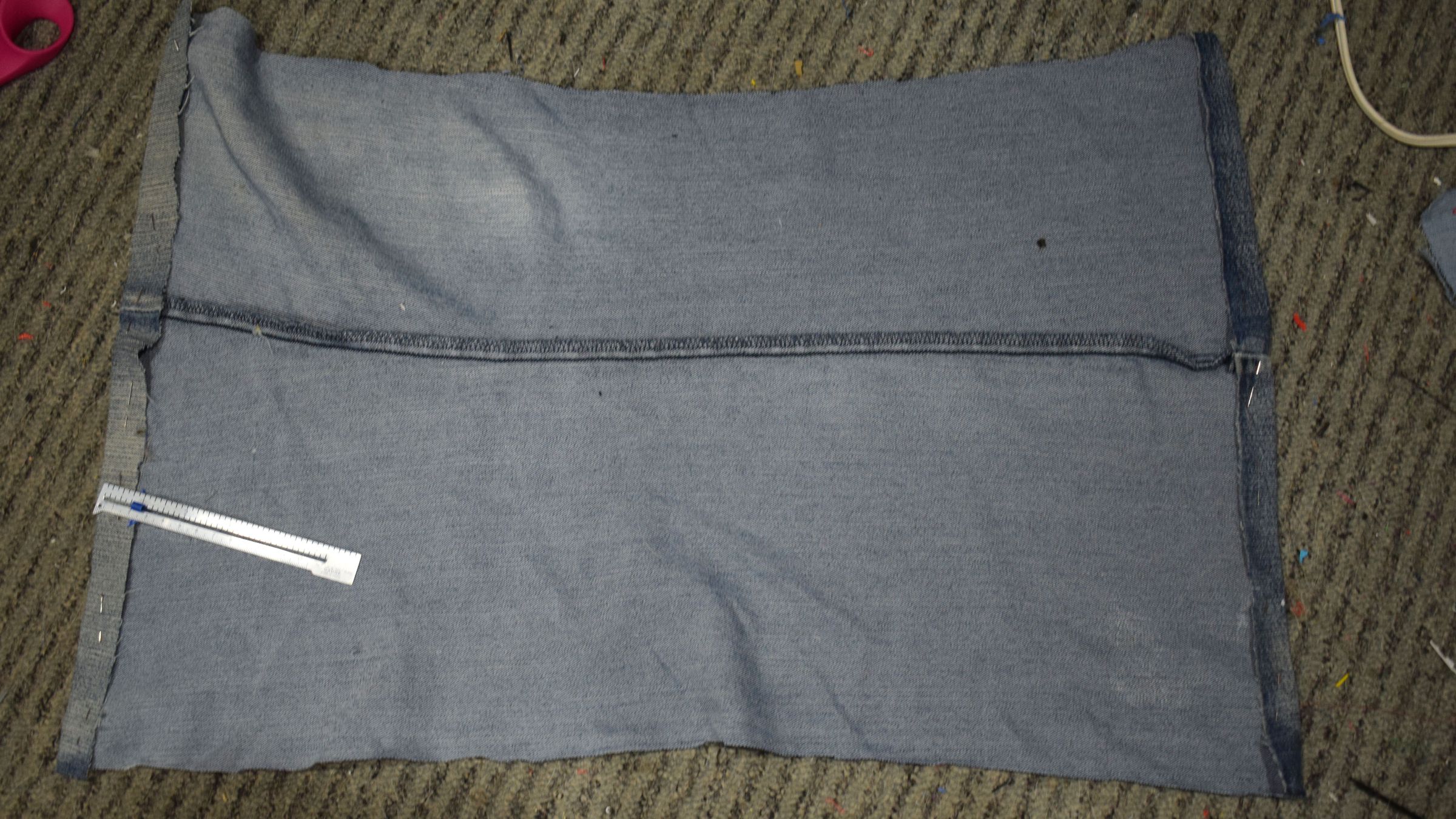

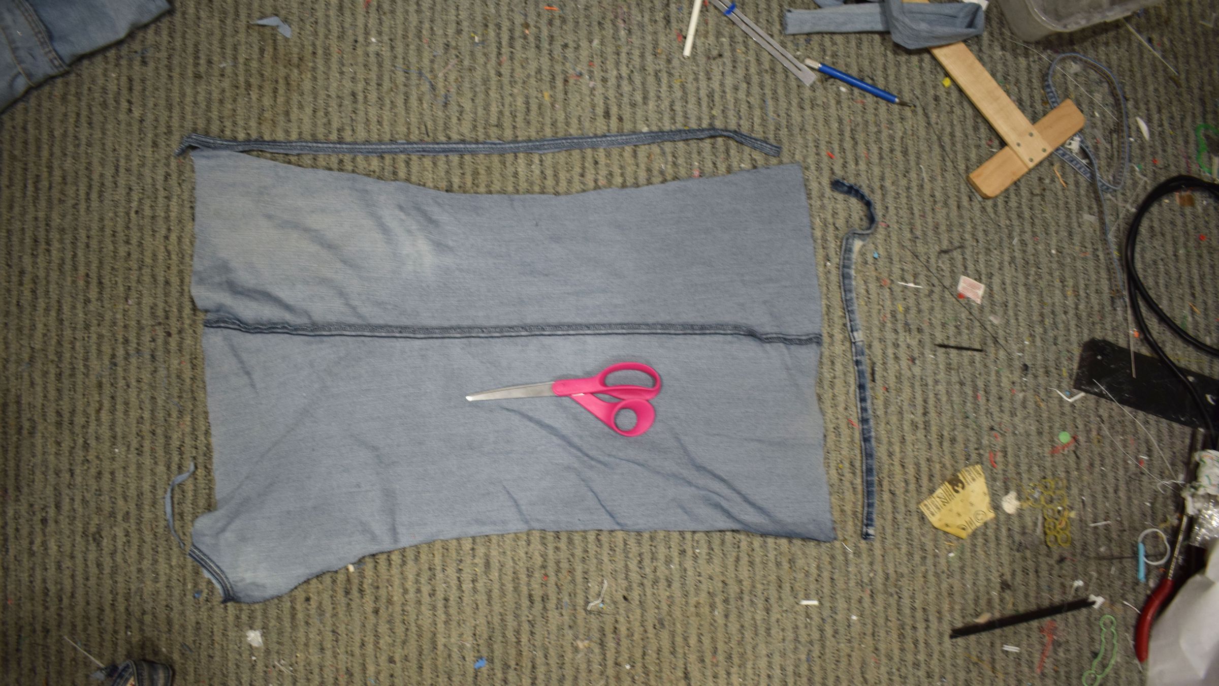

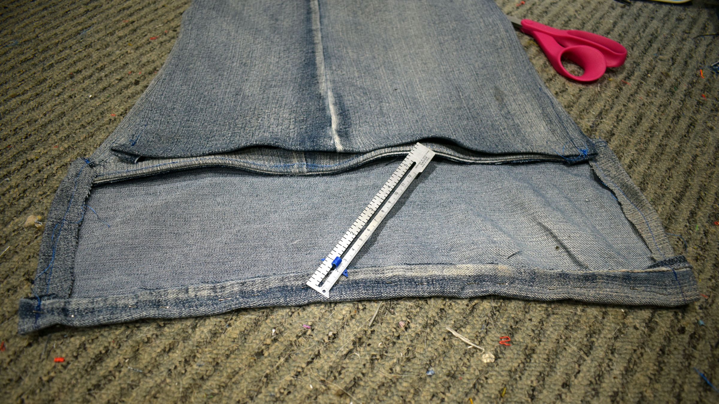

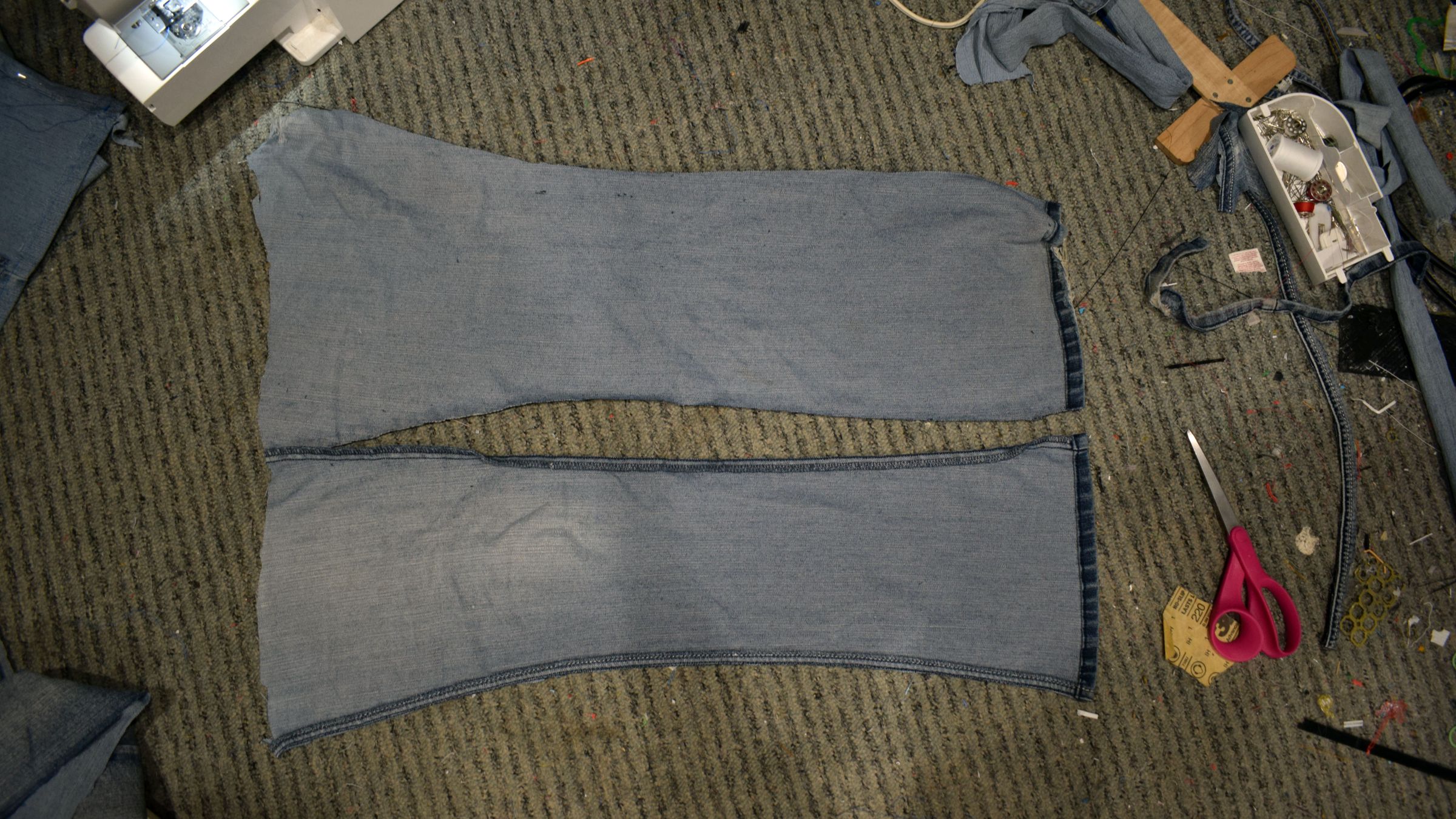

Step 2: Prepping the Bag
1. Take one of the pant legs and cut along the the inside seam.
2. Cut off the inside pant leg hem completely.
3. Lay the fabric out so that the inside fabric is topside. Cut off the bottom pant leg hem.

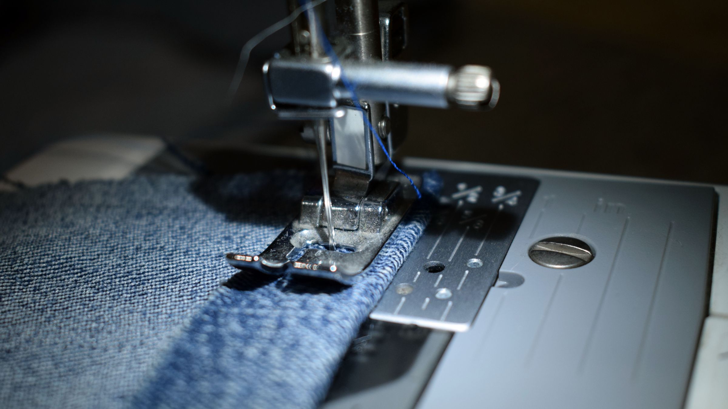

4. With a ruler, fold the bottom of the pant leg inwards about 2cm (0.78") to create a new hem. Pin down. To help create a fold use a steam iron to press fabric into a fold.
5. Repeat step 2 for the top of the pant leg.
6. Sew both hems down about 3/8".

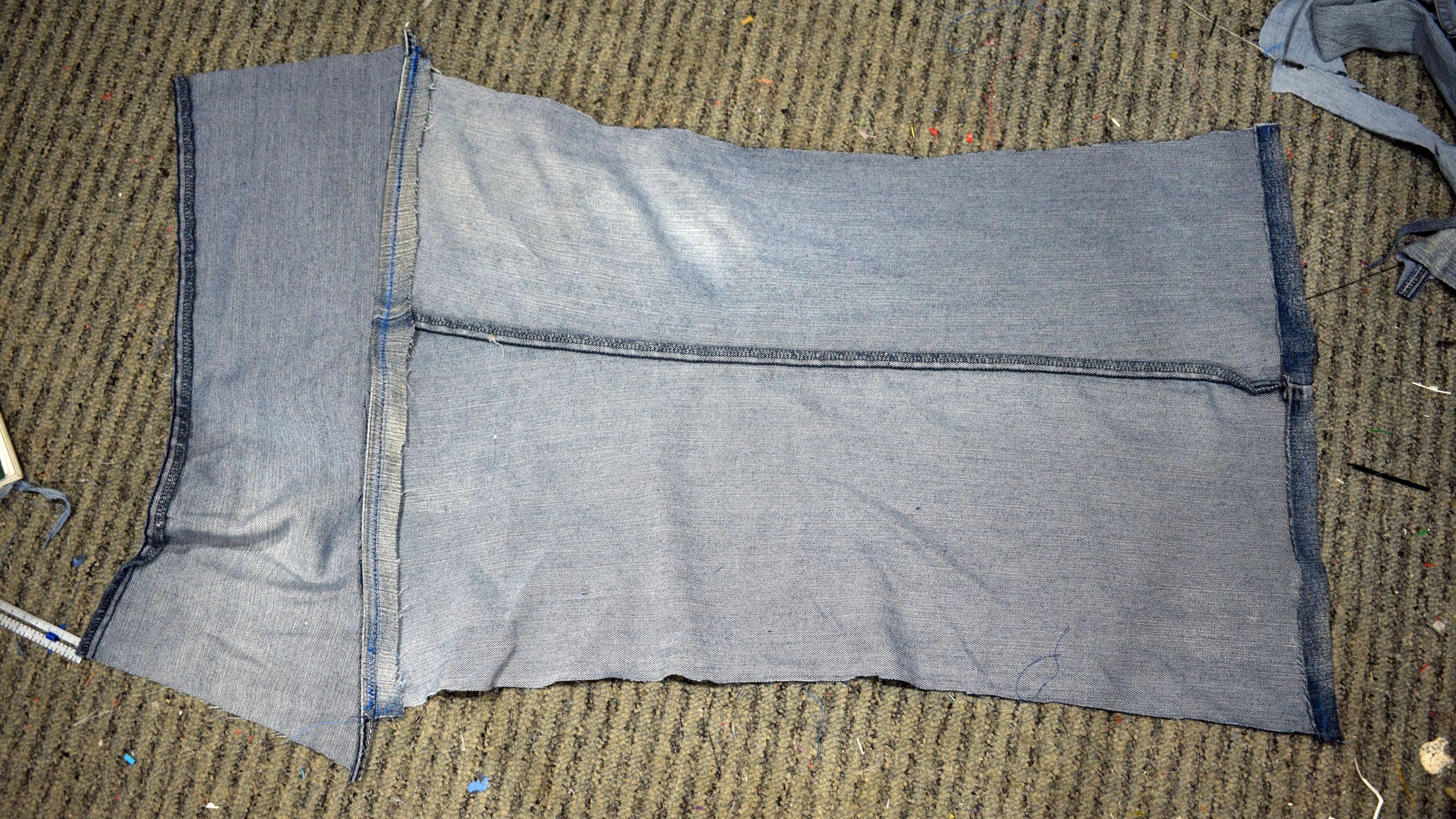

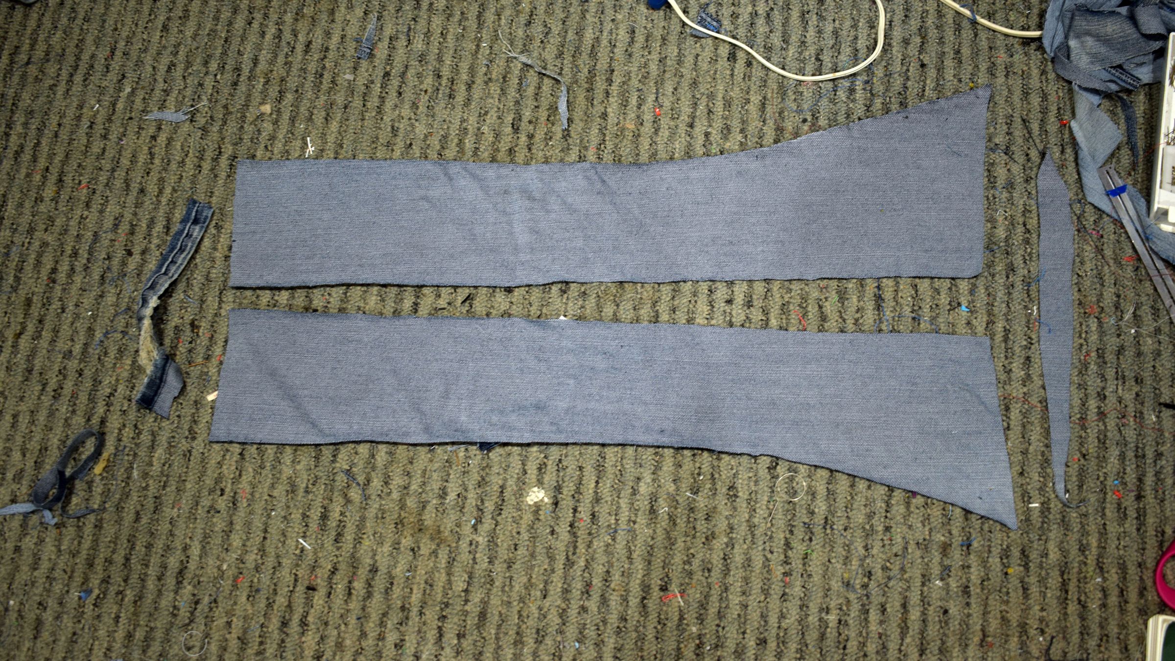

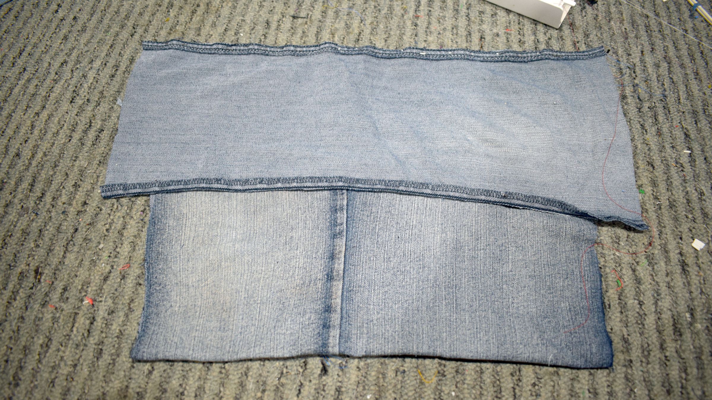

Step 3: Adding Bag Flap
1. Take the other pant leg and cut in half up the length of the paint leg. Set one half aside.
2. With the other half cut so the length of the leg is about 1 to 1 /12" longer than the width of the bag.
3. Take the bag fabric and fold in half with frontside fabric facing out. Choose which side will be the back side of the bag. Pin the flap with backside of fabric facing topside. Pin fabric to the top edge the backside of your bag.
4. Sew flap to backside of bag 3/8" inward. I used a zigzag stitch for this part.
5. Fold top of bag flap inward 2 cm and pin. Sew together with a 3/8" seam.

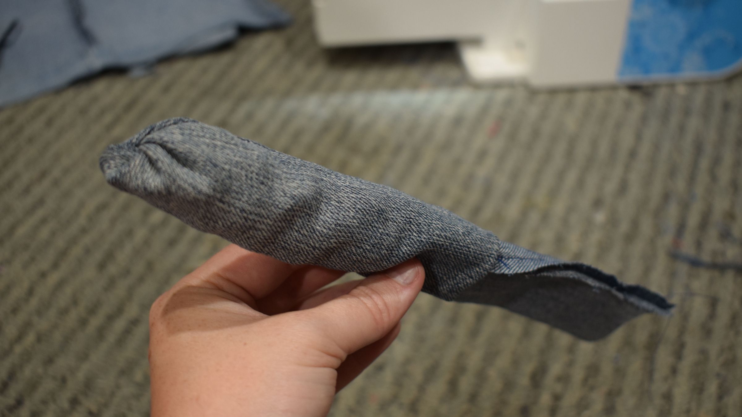

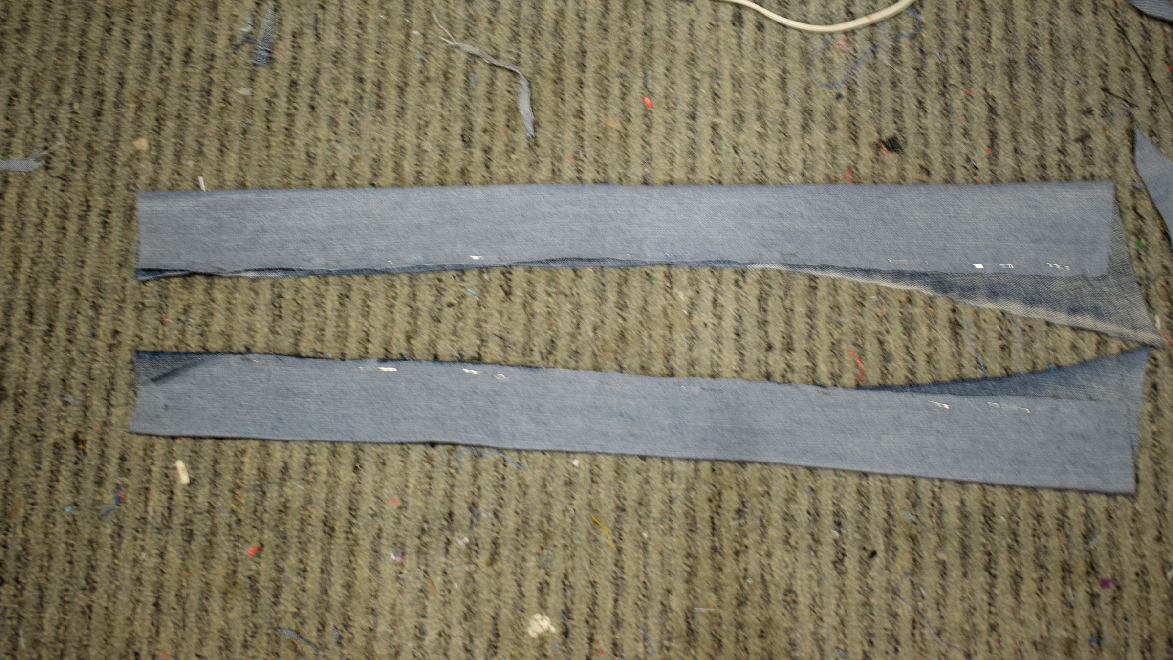

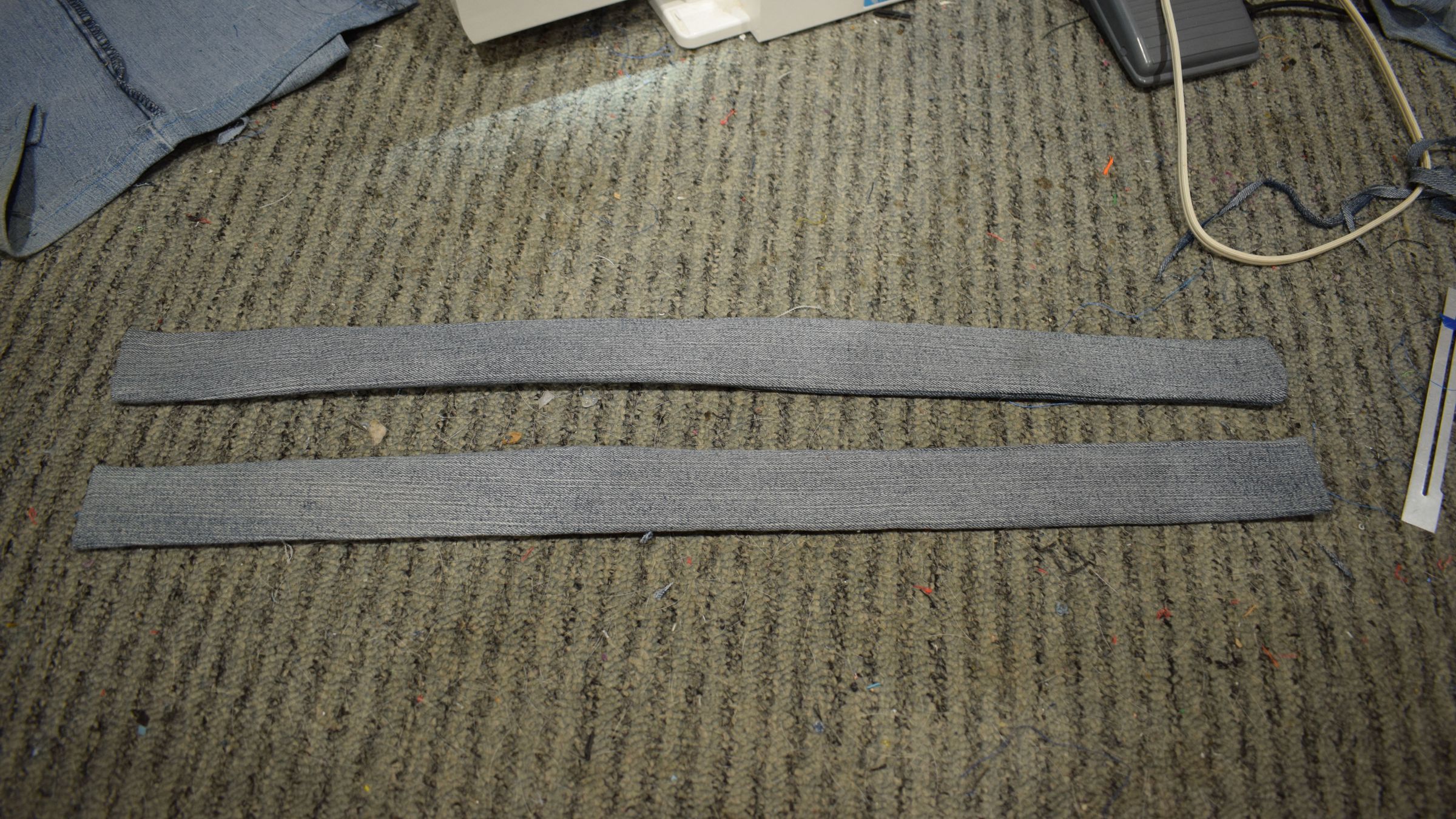

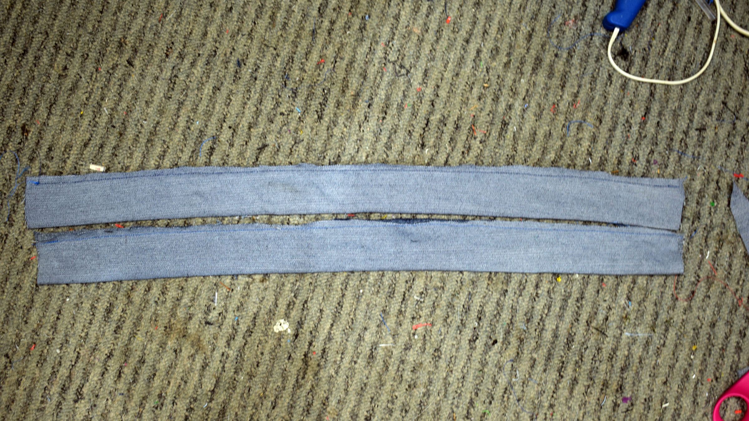

Step 5: Straps
1. With the last remaining pant leg half, trim off bottom hem and even out pant leg top. Cut in half lengthwise.
2. Fold in half with "backside" of fabric facing outwards. Pin edges.
3. Sew straps at 1"
4. Flip straps so front side is on the outside.
5. Fold edges inward about 2 cm. Hot glue or sew shut.

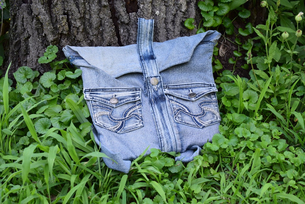

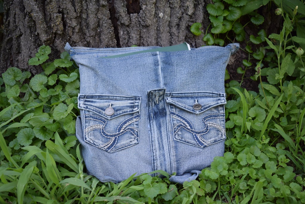

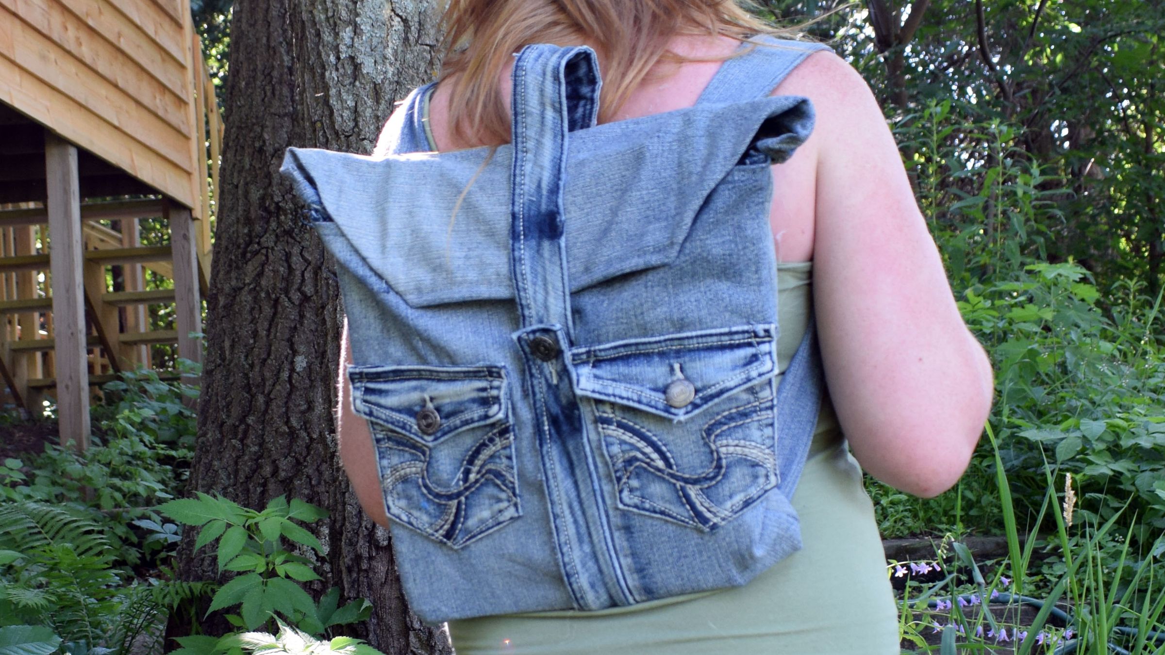

Step 11: Final Results
