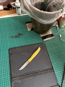

Step 1: Clean Old Cover
In a warm climate, most types of skai and PU leather do not have a long life, but the lifespan is also limited in a colder climate. This tablet cover is made of PU leather and became sticky due to the heat so the top coat is damaged. At first glance it’s a case of garbage can.
I decide to take off the top layer first. The inside is still good so I don't do anything about that.
I remove the top layer on the outside by scraping off the layer bit by bit with the blunt side of a kitchen knife. Slowly the cover is starting to look better.
When the top layer is off, a textile layer remains, which I clean and make grease-free with alcohol. Then I put the cover aside and start on the new upholstery, I use fabric from a discarded surf kite.
