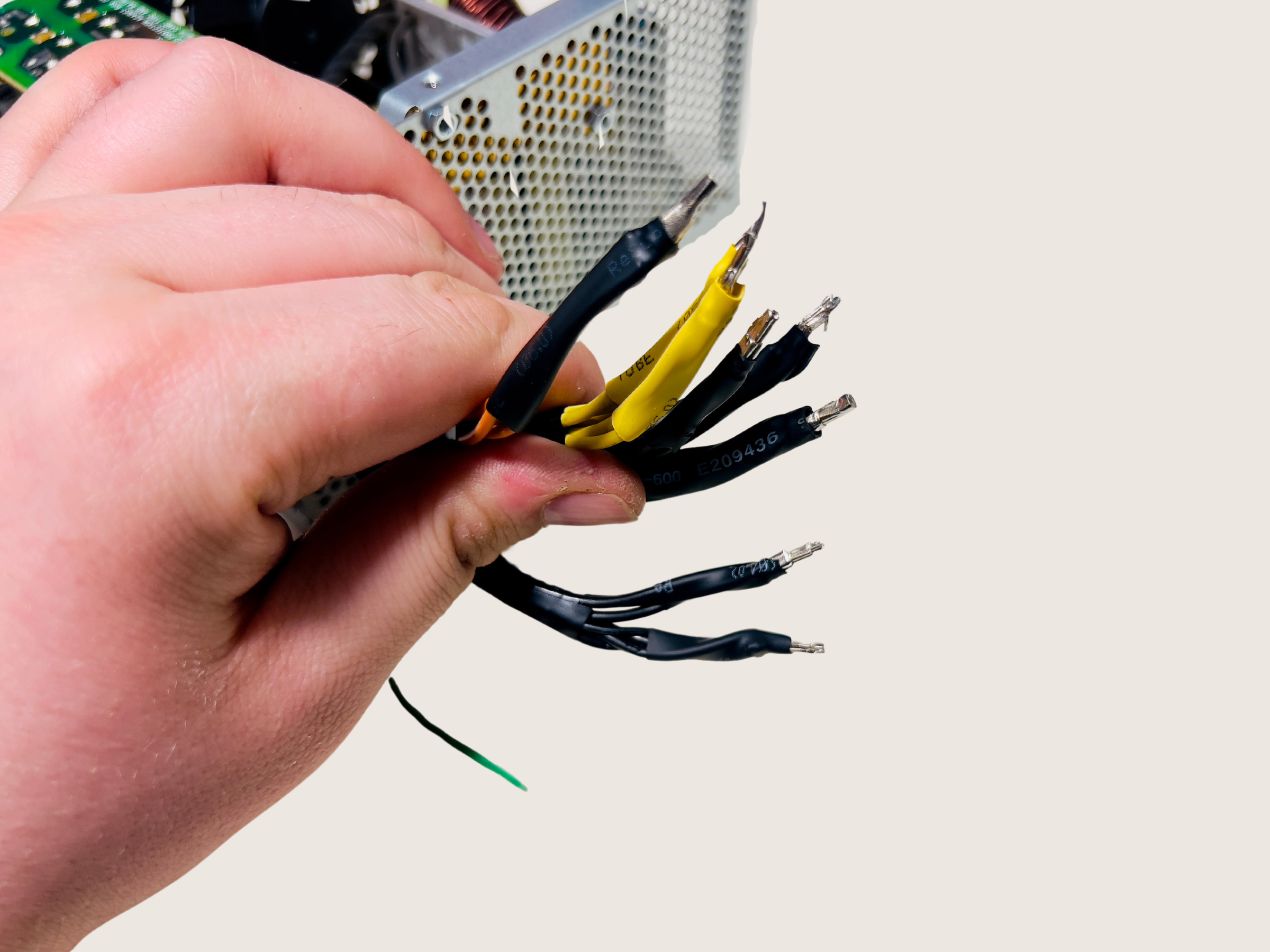

Prepare the Wires

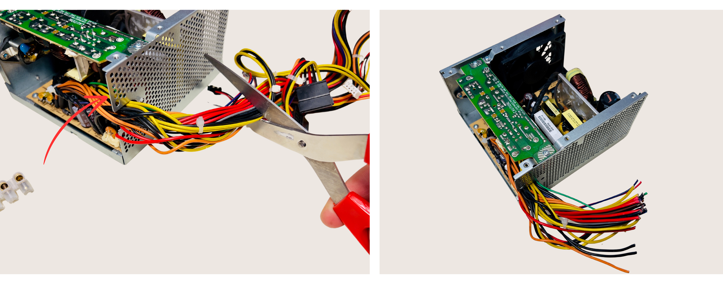

Trim Wires: Cut all protruding wires to about 10 cm in length to ensure they are manageable and uniform.
Identify and Group Wires: Sort and label the wires by their color and function:
- Yellow for 12V
- Red for 5V
- Orange for 3.3V
- Black for Ground
- Green for the power-on signal
Separate one red and one black wire from the groups; these will be used later to connect the load resistor.

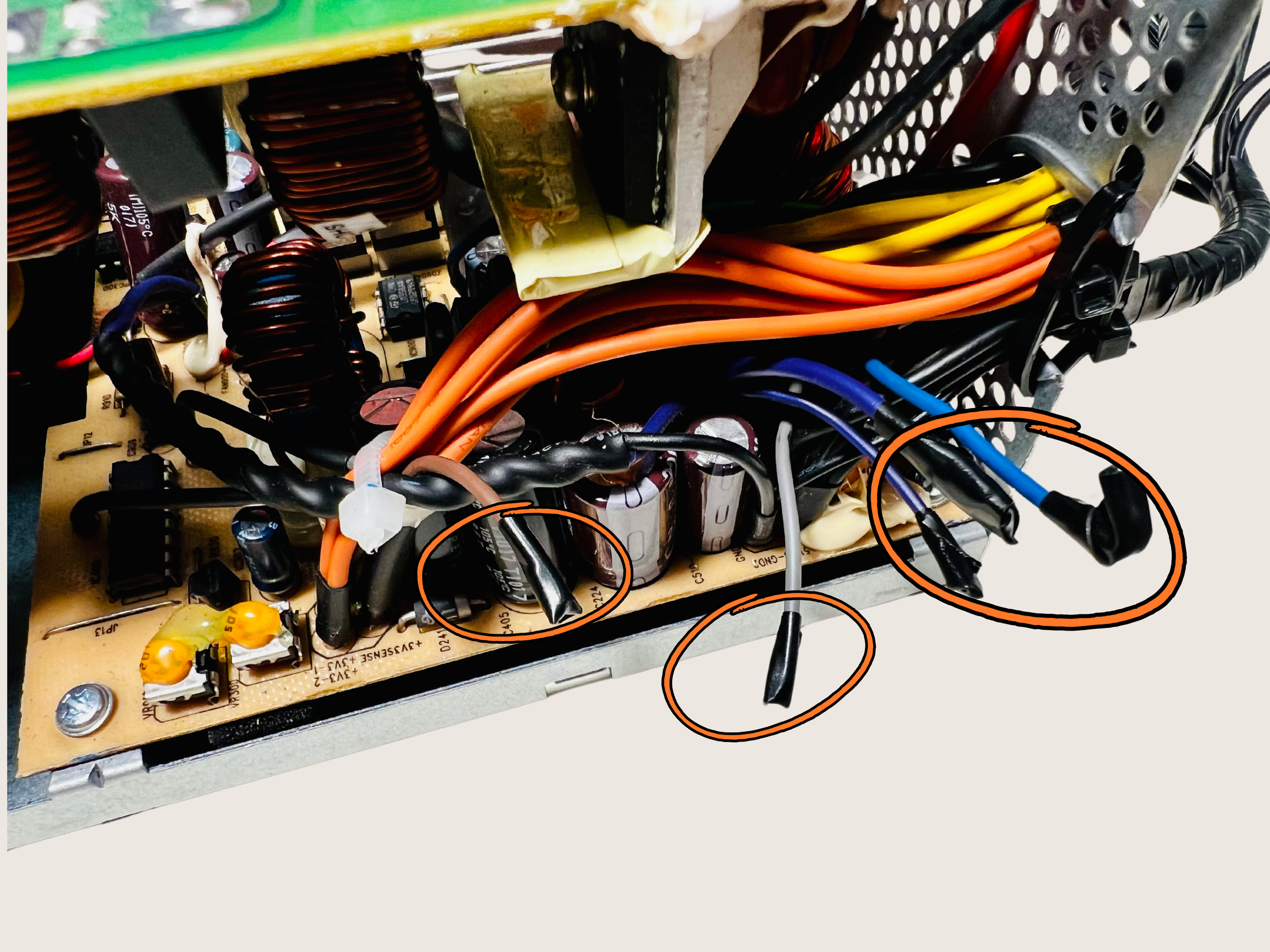

Deactivate Unused Wires: Cut off and securely tape the ends of unused wires (purple, grey, brown, blue, etc.) to prevent accidental contact. You can also use heat shrink tubing for an even more secure seal.

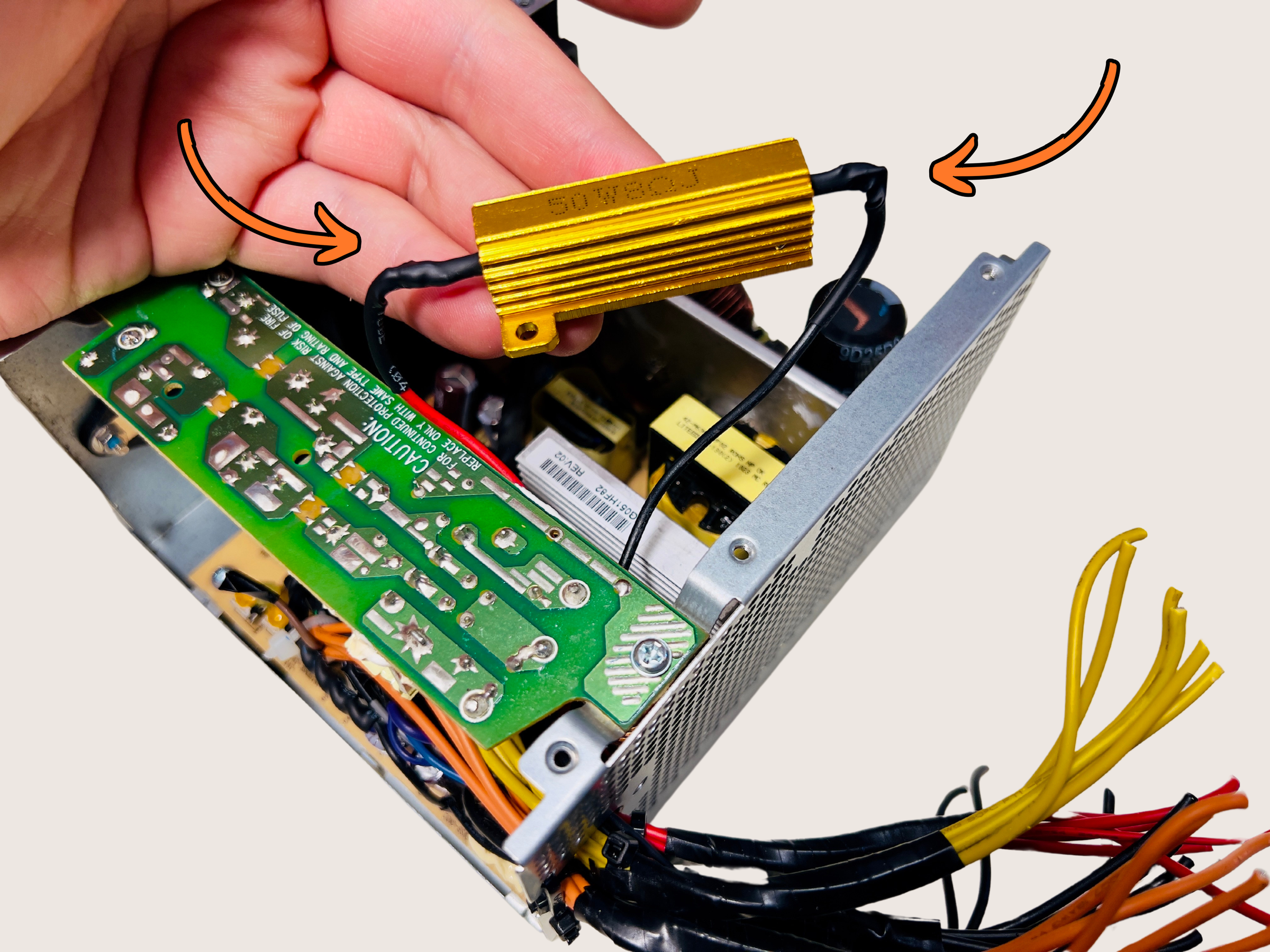

Install the Load Resistor
Prepare the Resistor Wires: Take the previously isolated black and red wires, solder them to the load resistor, and apply heat shrink tubing for insulation.
Mount the Resistor: Securely screw the resistor onto the PSU’s interior wall that has mounting holes, ensuring it is firmly attached and stable.

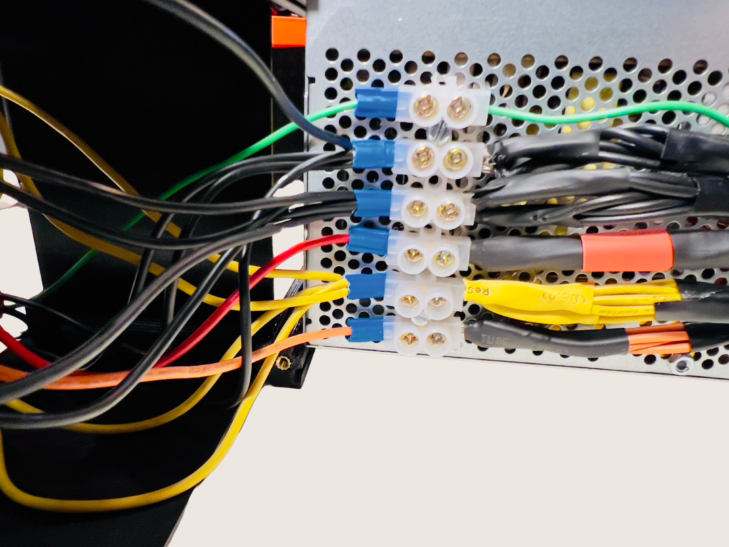

Organize and Secure Wire Connections
Crimp and Bundle Wires: Combine all the grouped wires into a single connector per group using the ferrule sleeves and apply heat shrink to ensure a durable and insulated connection. (Please note, since my ferrule sleeves had not yet arrived i used uninsulated tin plated copper sleeves in the picture below. This is not recommended)
Prepare the Terminal Block: Cut off a terminal block to have 6 slots. Insert each crimped wire bundle into its corresponding slot - two slots for black (ground) wires, one for orange (3.3v), one for red (5v), one for yellow (12v), and one for the green (power-on) wire.
Attach the Terminal Block: Securely screw the terminal block onto the frame of the PSU to stabilize the connections and ensure easy access.

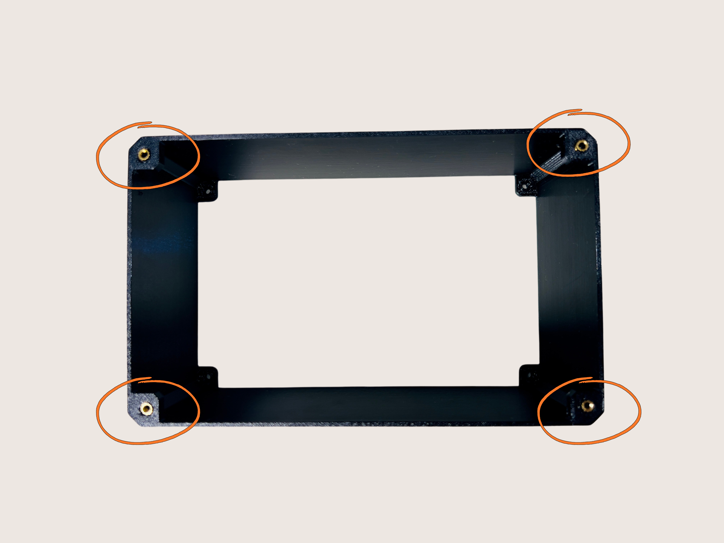

In this step, we'll prepare the frame and panel for the upcoming circuit assembly by inserting brass inserts into both the frame and housing. We will also install all necessary components onto the panel.
Inserting Brass Inserts
Insert into the Frame: Position an M3 brass insert at the designated insertion holes on the 3D printed frame. Carefully press the heated brass insert into the plastic with a woodburner or soldering iron. Apply gentle pressure until the insert is flush with the surface or slightly below. Repeat for each insert required by the frame, ensuring they are evenly aligned and securely fitted.
Insert into the Housing: Repeat the insertion process for the housing. Check each insert for stability and correct depth to avoid any misalignment during the component installation.

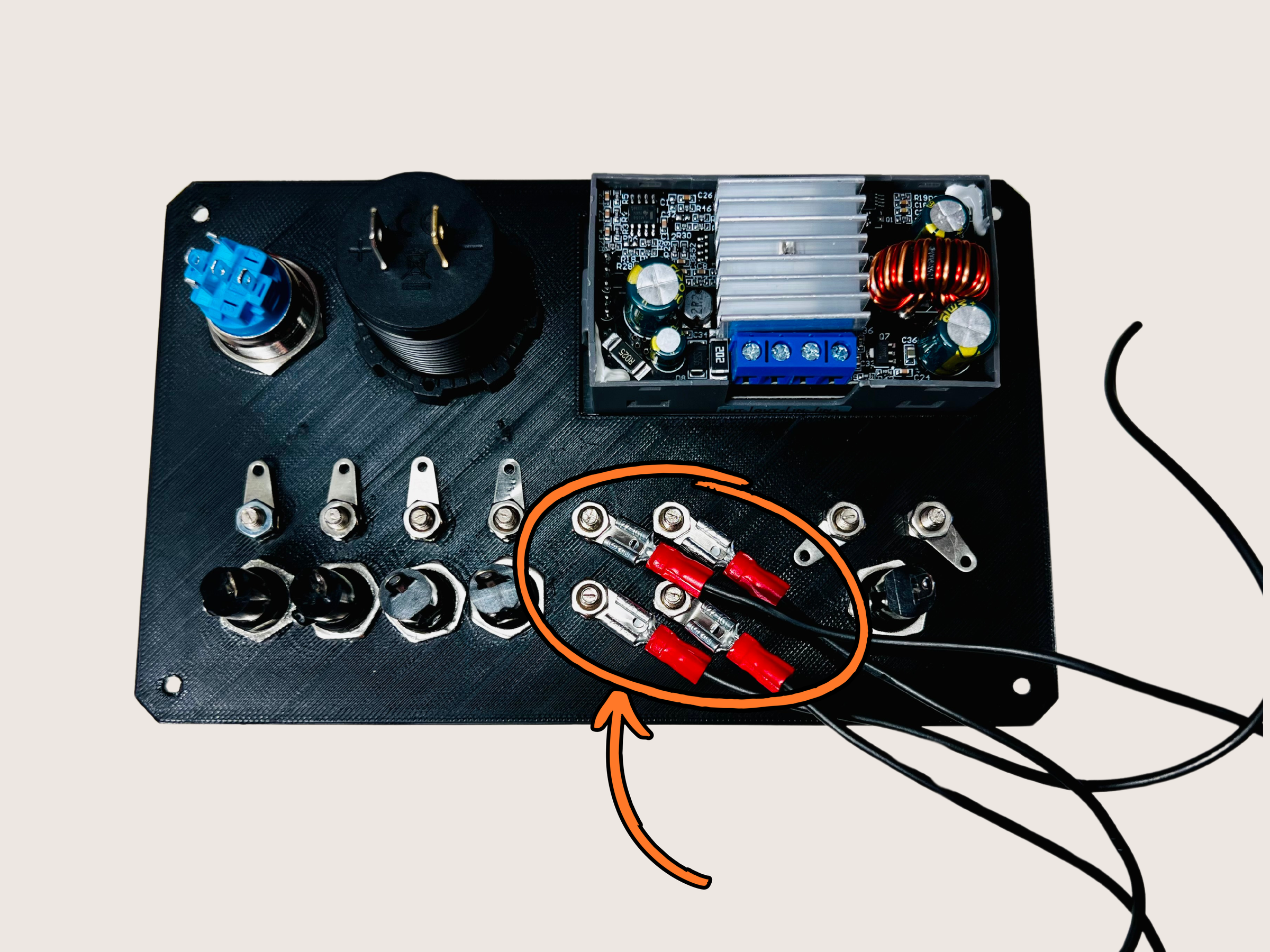

Connecting the Negative Banana Plugs: Begin by connecting one black wire to each of the four negative banana plugs adjacent to each other as depicted in the image.

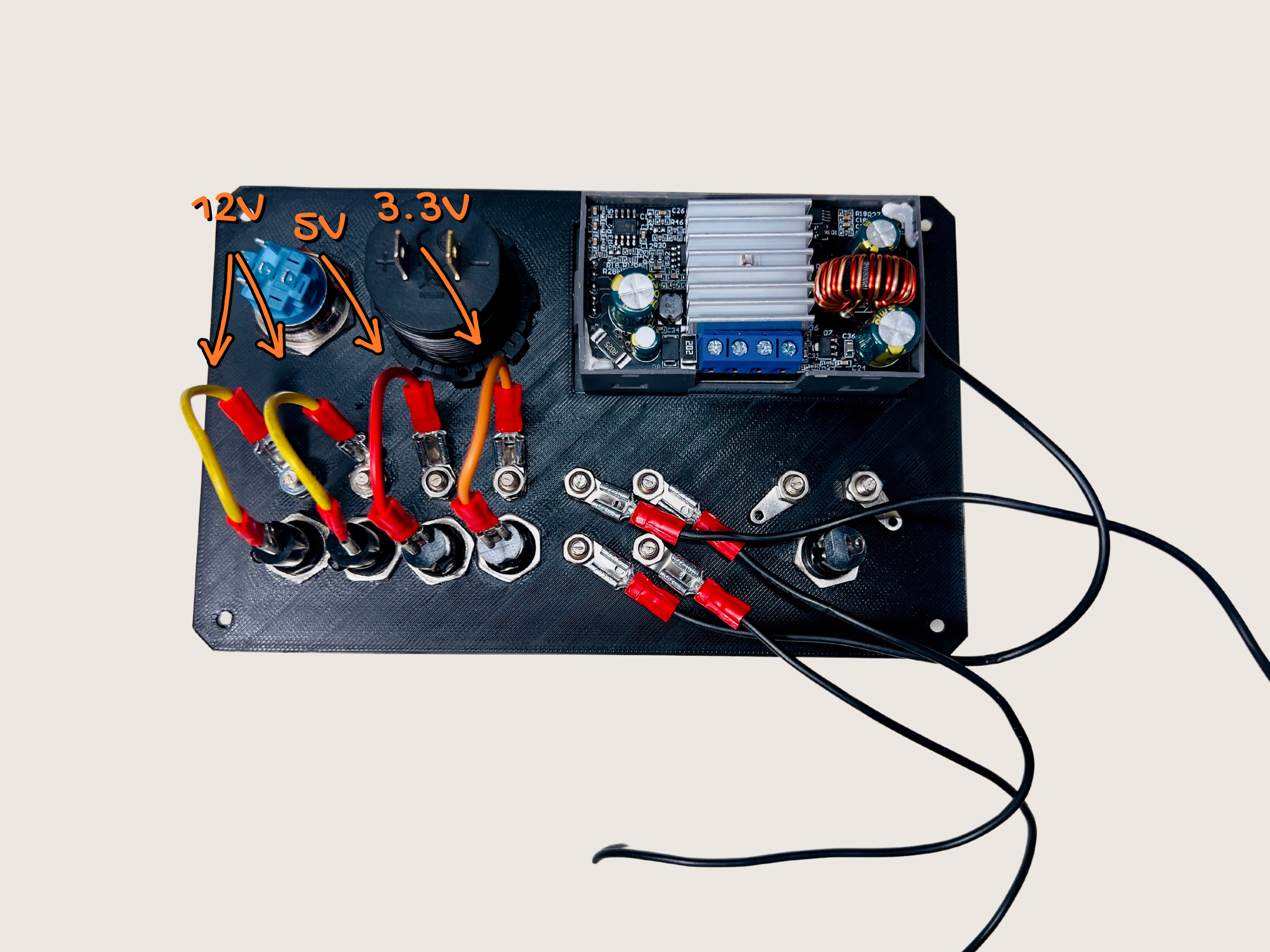

Connecting the Positive Banana Plugs: Attach one pin on all of the fuse holders to the red banana plugs using the appropriate colored wires cut from excess PSU wires: yellow for 12V, red for 5V, and orange for 3.3V.
Connecting Fuse Holders: Add a longer wire to the second pins on the fuse holders using corresponding colors for each voltage level.

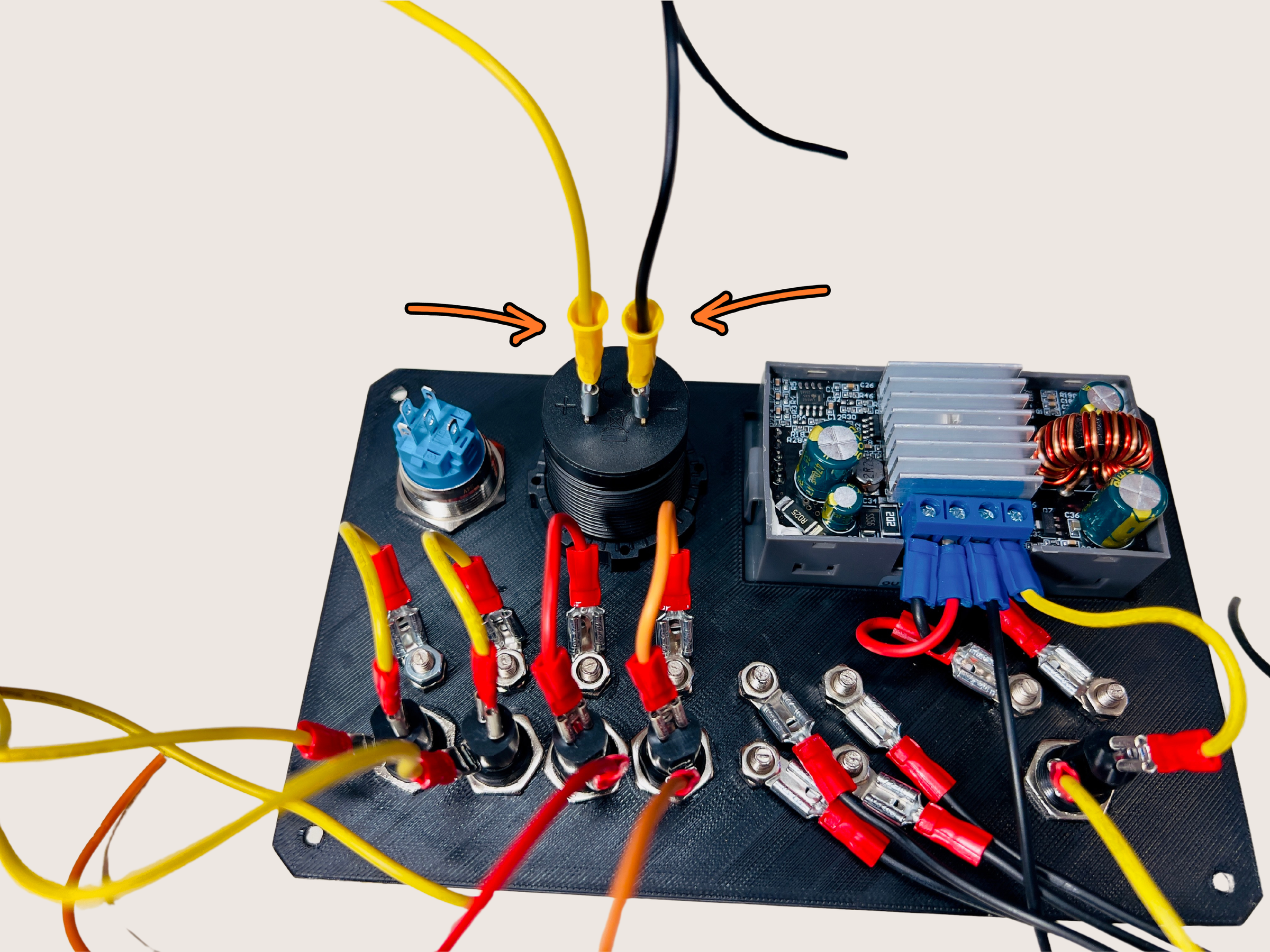

Variable Output Banana Plugs Wiring: Connect the variable output banana plugs to the OUT+ and OUT- of the module. Attach the black wire from the black banana plug to the OUT- and the red wire from the red banana plug to the OUT+.
Buck Boost Converter Wiring: Wire one black wire to the IN- and one yellow wire (12V) from the fuse holder to the IN+ on the variable voltage module. Connect another longer yellow wire to the second pin of the fuse holder.
USB Wiring: Connect one black wire to the - pin on the USB hub and one yellow wire to the + pin to establish the USB power supply.
Power Button Wiring: Complete the wiring by connecting the power button. Attach the green wire to the specified pin for power-on, ground to another, and a red wire for 5V to power the LED lights in the button. Follow the diagram in the beginning of this step.

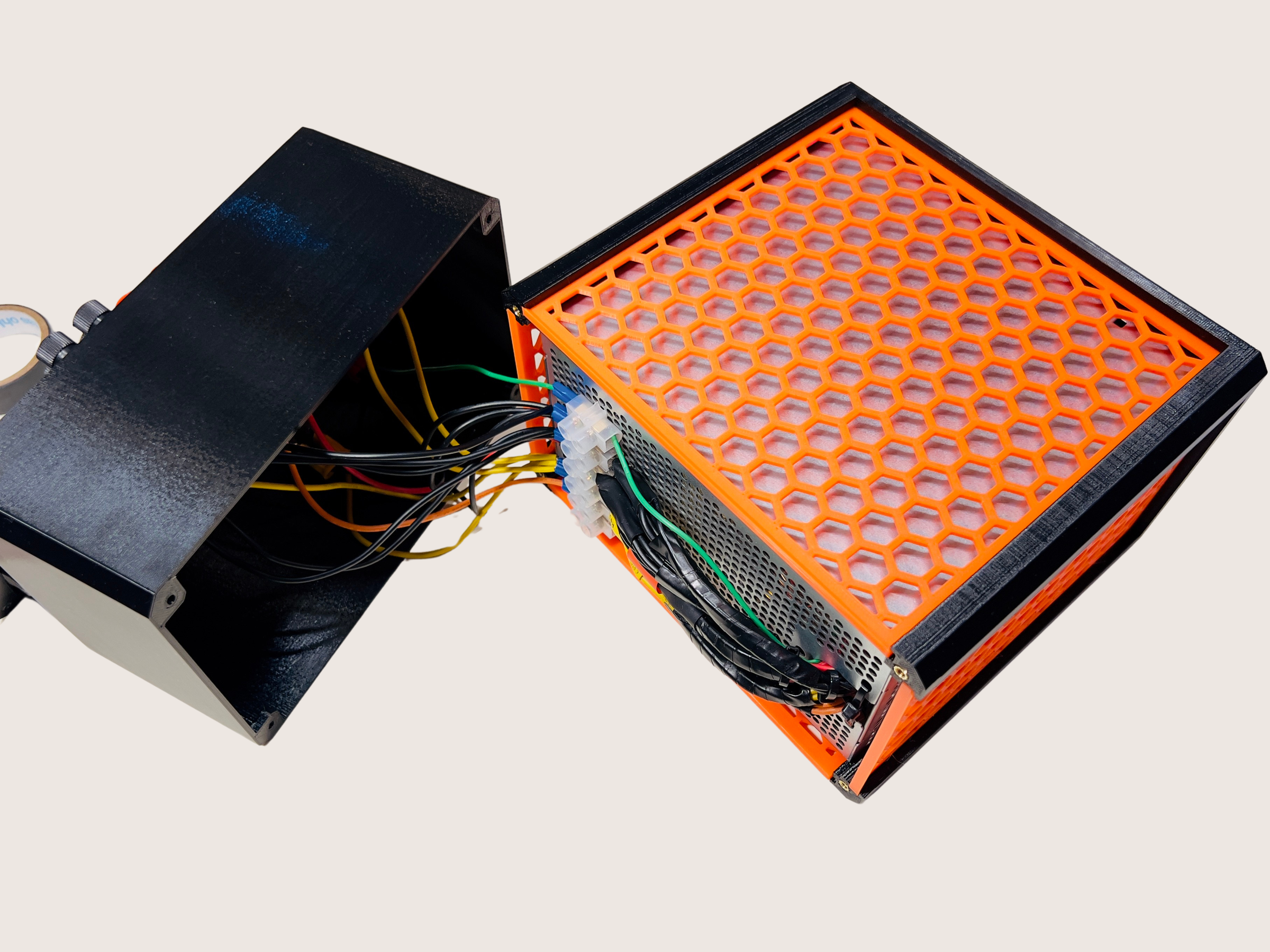

Screw the Frame onto the PSU: Begin by securely screwing the 3D printed "Frame" onto the PSU to ensure it is held firmly in place.
Thread Wires Through the Housing: Carefully thread all wires from the panel through the openings of the 3D printed "Housing" to prepare for connection to the terminal.
Connect Wires to Terminal: Attach each wire to its corresponding color on the terminal, matching the color-coded wires to ensure correct connections.
Slide in the Hex Panels: Insert the 3D printed "Hex" panels into the frame.
Attach the Housing to the Frame: Secure the housing to the frame with screws to enclose the electronics neatly.
Mount the Panel: Mount the panel to the housing using four screws to close it all up and complete the assembly.
